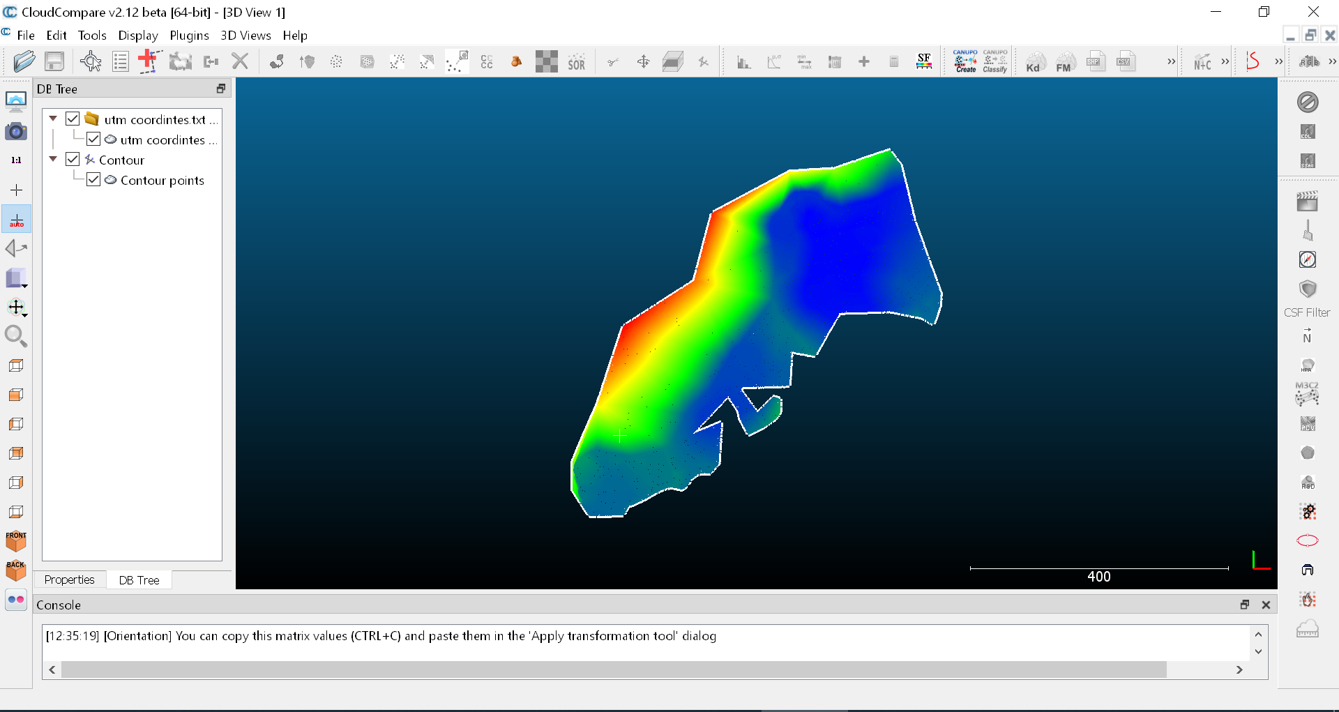

I use Fit >> 2D polygon facet on only XY UTM pointscloud to find the perimeter of 1 million points (from mesh >> sampled points)
In some cases, facet algorithm fails to perfectly find perimeter, and changing the max edge does not help.
However if during opening UTM pointscloud , the global shift is enabled, facet algorithm succeeds
I propose to modify the facet algorithm to silently use global shift during execution.
I use the latest cc V2.12 beta
In this screenshot, global shift is enabled and max edge =2
In this screenshot, global shift is disabled and max edge =2
please check attached pointscloud (segmented to fit in 2 MB zip file)
utm coordinates2.zip
(1.78 MiB) Downloaded 1496 times
