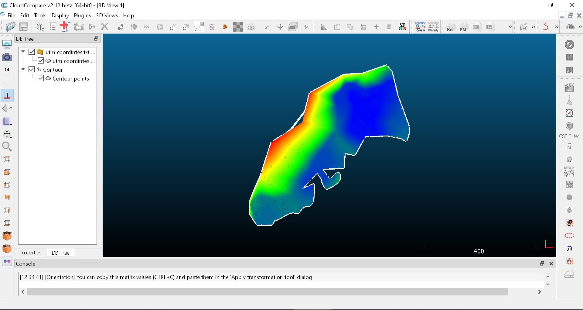

I use Fit >> 2D polygon facet on only XY UTM pointscloud to find the perimeter of 1 million points (from mesh >> sampled points)
In some cases, facet algorithm fails to perfectly find perimeter, and changing the max edge does not help.
However if during opening UTM pointscloud , the global shift is enabled, facet algorithm succeeds
I propose to modify the facet algorithm to silently use global shift during execution.
I use the latest cc V2.12 beta
In this screenshot, global shift is enabled and max edge =2
In this screenshot, global shift is disabled and max edge =2

You mean that you sometimes open points with large coordinates without applying the Global Shift?!
Did you understood the consequences? You'll lose a lot of accuracy, and this is probably why the 'Facet' algorithm fails (as many other things). And no, it's too late to shift the points afterwards, since they can only be shifted at loading time (otherwise the accuracy is already lost once stored in memory by CC).
