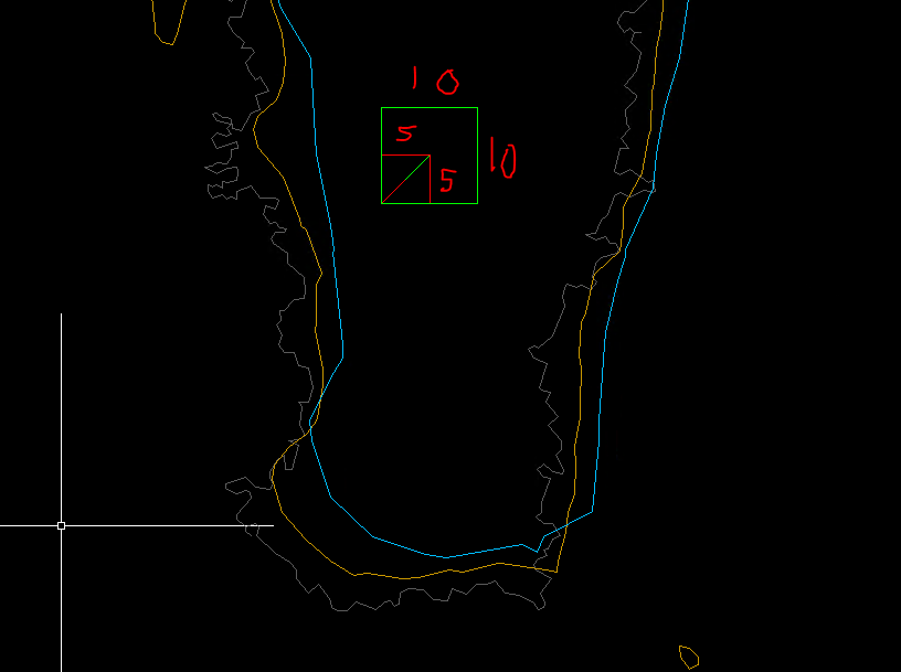

Hello guys,
I just came across this issue as well and I think I have figured it out. When cloud compare creates a raster grid it doesn't put the new point in the right X,Y co-ordinate. As such if you make a 10 m average grid then you will see a shift in your contours by 7.0711 m to the north-east.

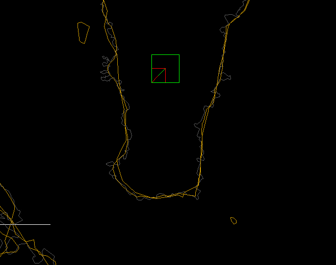

The easiest fix for this is to simply shift the points to the south-west by a value found using this formulae: shift distance = (Grid spacing * Sqrt(2))/2 or just subtract half of the grid spacing from your x and y values.
Daniel would it be possible to have this shift added into Cloud Compare?
Here are a couple pictures of the surface i'm working with. Grey is as provided by a surveyor, orange is a 5 m average raster and the blue is a 10 m average raster. Red square is 5 x 5 square, green is 10 by 10 square.
Unadjusted:
unadjusted surfaces.PNG (29.6 KiB) Viewed 16704 times
Shifted:
adjusted surfaces.PNG (10.6 KiB) Viewed 16704 times
kind regards,
Andrew
Re: Contour line difference CloudCompare
Posted: Mon May 28, 2018 8:40 pm
Which version are you using?
Posted: Tue May 29, 2018 2:08 am
by AndrewPerth
I've currently got v2.9.1 (64 bit) installed.
Andrew
Posted: Tue May 29, 2018 5:39 pm
Hum, the 2.9 version was already relying on GDAL to produce contour lines so I'm a bit surprised.
But I guess I'll apply the shift of half a cell then? (to be on the safe side, can you express it in terms of X,Y coordinates?)
