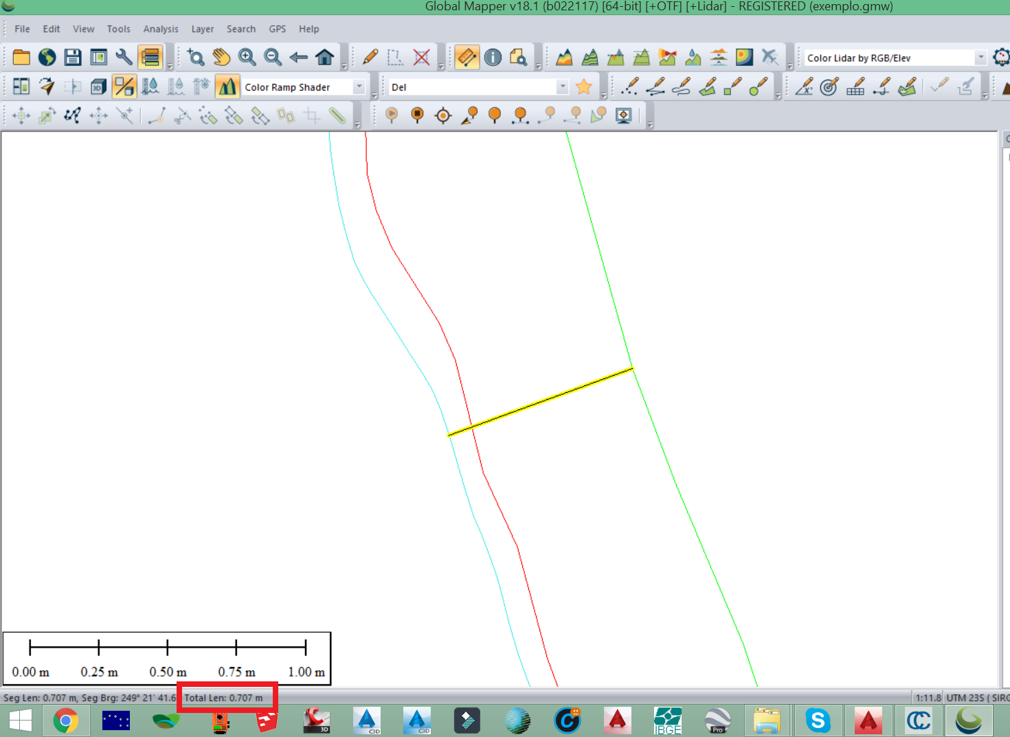

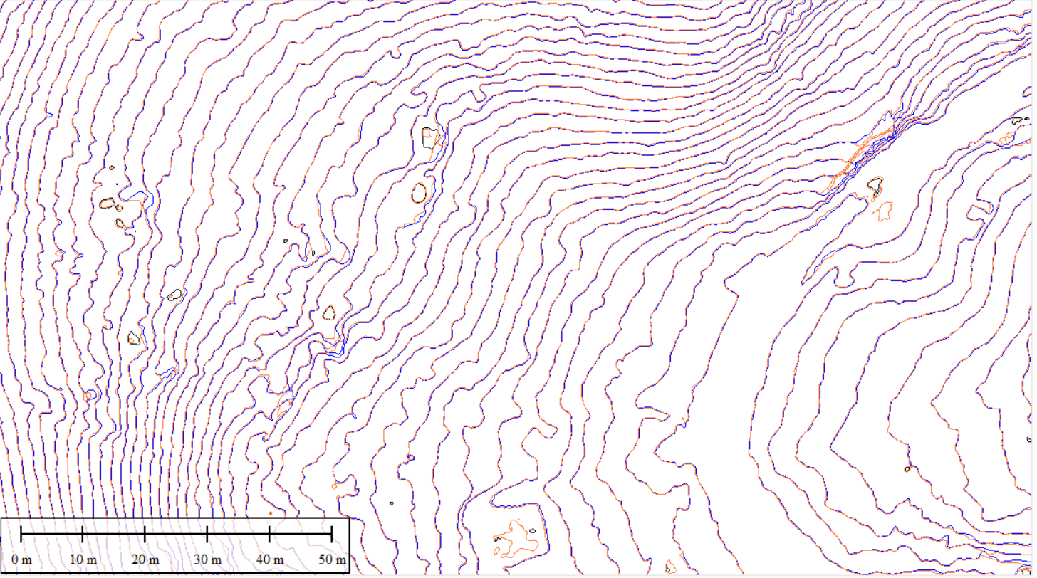

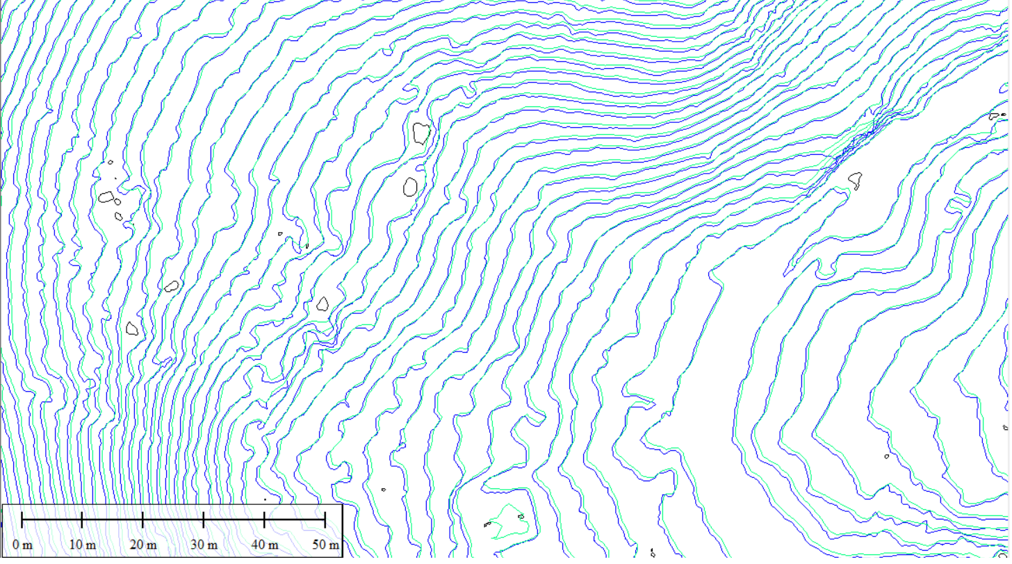

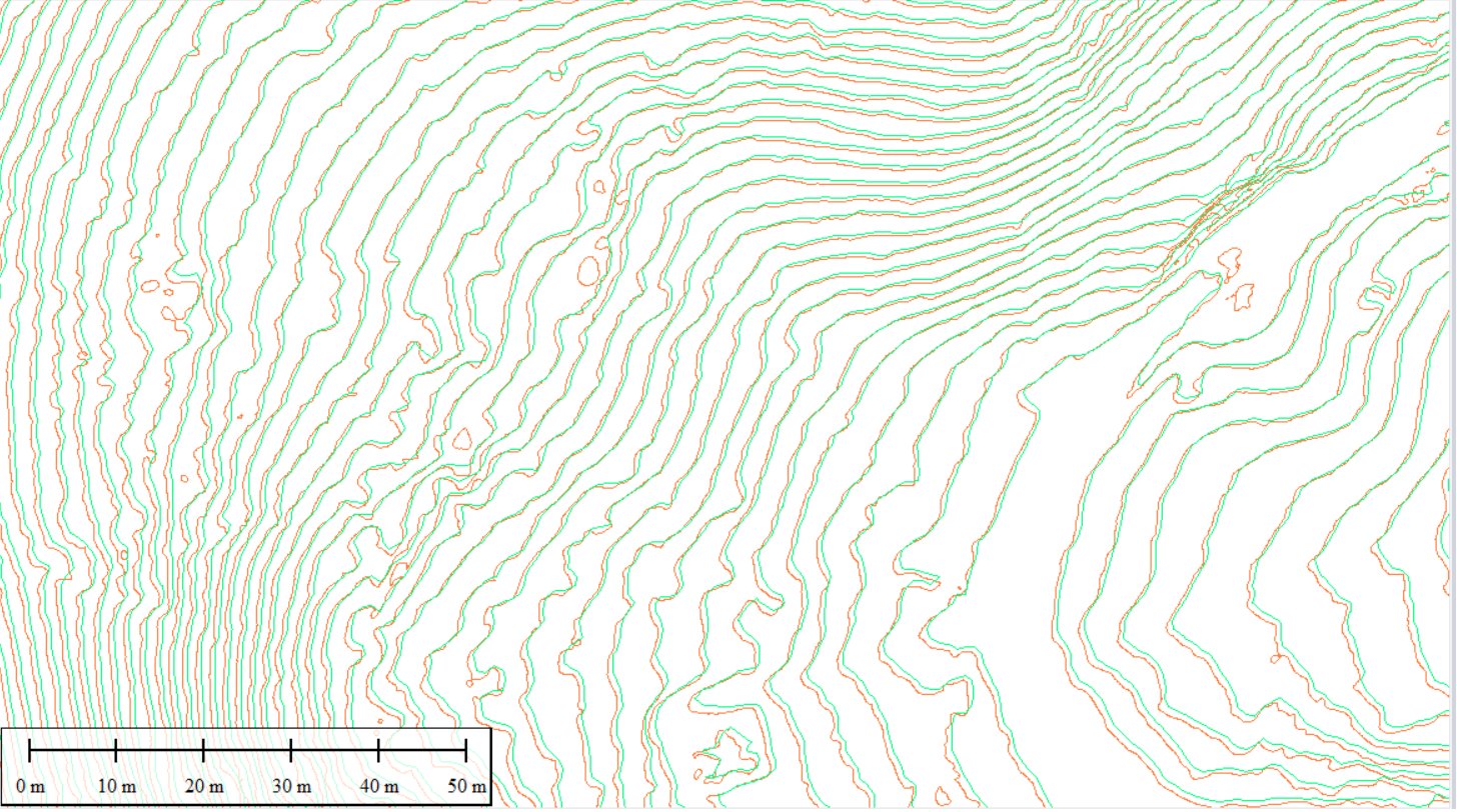

I'm using Cloudcompare a few days and by the way very good software. I did some testing by drawing contours and exporting in dxf format compared to some other software like GlobalMapper, Photoscan AgiSoftware. There is a significant difference in the design of the Contour Lines in the design of the contours in the CloudCompare. See the attached drawing. Line in green color are from CloudCompare software. Version 2.10 Alpha.
- GlobalMapper x Photoscan.png (250.43 KiB) Viewed 16874 times
- CloudCompare x GlobalMapper.png (305.9 KiB) Viewed 16874 times
- CloudCompare x Photoscan.png (283.5 KiB) Viewed 16874 times
Re: Contour line difference CloudCompare
Well, the most evident answer is that we probably don't use the same algorithm to generate the contour lines? (in the latest version we use GDAL's).
And are you using the exact same raster to test this by the way? Otherwise the raster generation parameters may differ?

Daniel, yes I'm using the same source, not raster, but point cloud (.las) exported from CloudCompare. The distance difference in this case was approximately 70cm from a contour line to the one generated in the CloudCompare.

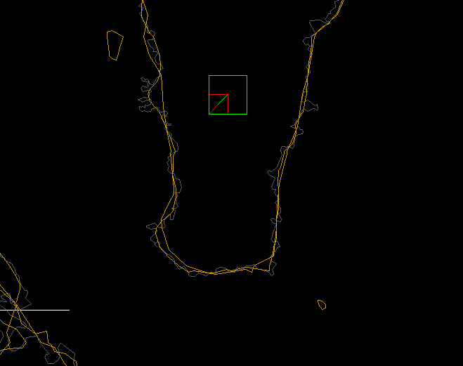

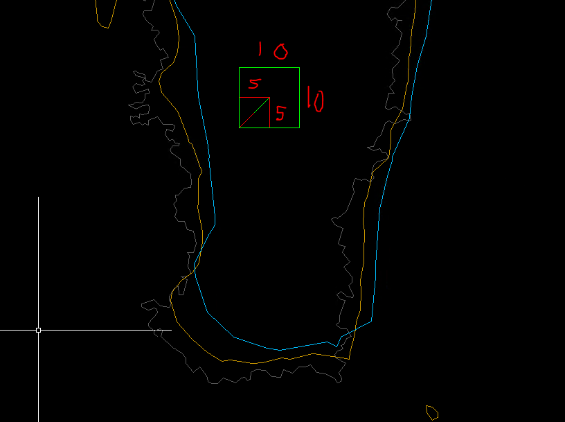

Hello guys,
I just came across this issue as well and I think I have figured it out. When cloud compare creates a raster grid it doesn't put the new point in the right X,Y co-ordinate. As such if you make a 10 m average grid then you will see a shift in your contours by 7.0711 m to the north-east.
The easiest fix for this is to simply shift the points to the south-west by a value found using this formulae: shift distance = (Grid spacing * Sqrt(2))/2 or just subtract half of the grid spacing from your x and y values.
Daniel would it be possible to have this shift added into Cloud Compare?
Here are a couple pictures of the surface i'm working with. Grey is as provided by a surveyor, orange is a 5 m average raster and the blue is a 10 m average raster. Red square is 5 x 5 square, green is 10 by 10 square.
Unadjusted: Shifted: kind regards,
Andrew
Andrew
Hum, the 2.9 version was already relying on GDAL to produce contour lines so I'm a bit surprised.
But I guess I'll apply the shift of half a cell then? (to be on the safe side, can you express it in terms of X,Y coordinates?)
