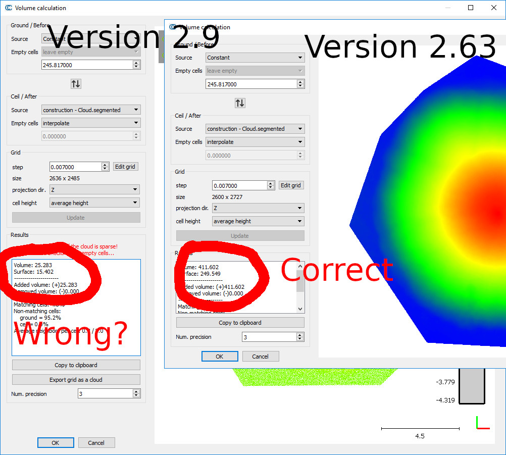

I am using a single point cloud to calculate the volume.
I am lost ?
am i missing something in new version?
I used 2.9.1 not 2.9 as pic says.
I get same in numbers 2.10 alpha
Version 2.6.3 is really close when judging by the amount of truck loads used.
I do indeed get sparse warning in new version but works great in older version and is really accurate to real volume.
I didnt save the work but the pile consists out of about 334945 points
old new.jpg (238.86 KiB) Viewed 18098 times

Well, the 'sparse' grid warning explains it all (I mean the wrong volume). Why is it working in the 2.6 version is the question... Can you send me the cloud maybe? (admin [at] cloudcompare.org).
One possibility is that there was a bug related to the grid step in the older version?! Anyway I guess you should still have a good volume with a step twice or thrice bigger than the current one (considering the grid size).

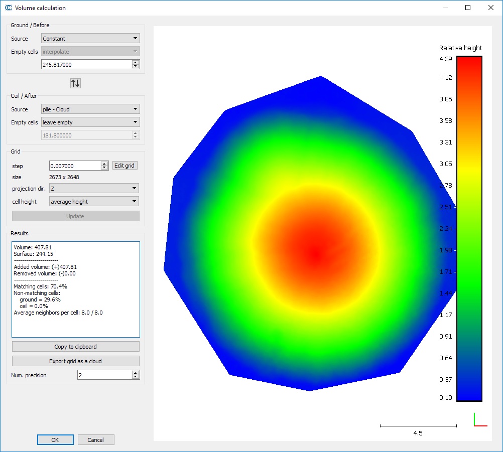

I finally found the issue! The strategy to fill the empty cells for the 'ceil' cloud was ignored. Only the 'ground' one was used.
I've updated the online 2.10.alpha version.
Thanks for the feedback ;)
Re: Calculated volume in 2.5 d changes with grid step size bug?
Posted: Sun Mar 18, 2018 2:16 am
by creature
Thank you for all your amazing hard work!
It's working now!
