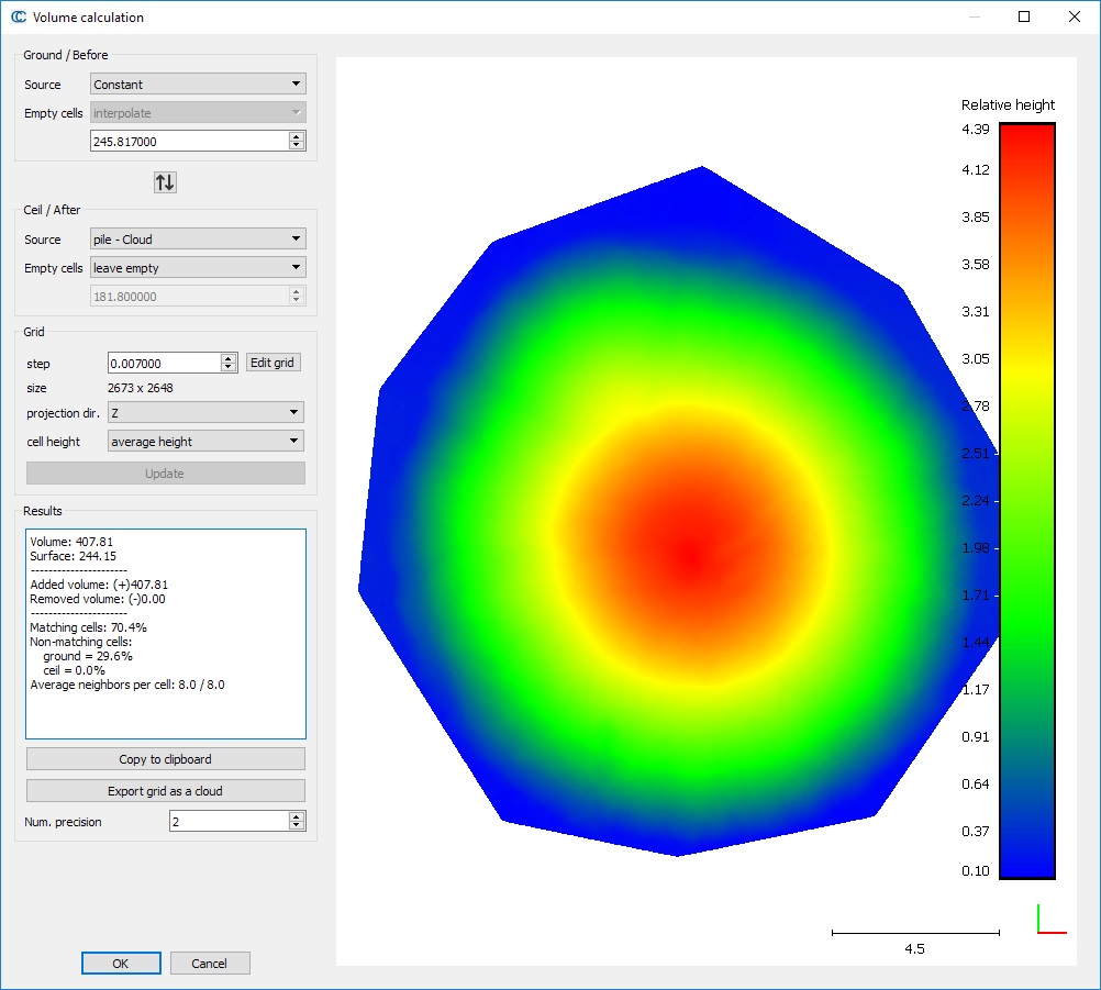

Hum, now I wonder if the bug was not in the 2.9 version! Because with the latest 2.10.alpha version, I get almost the same result as with the 2.6 one :D (well I forgot to activate the interpolation mode, but the result has the same magnitude at least).
I realize now that the result you get with the 2.9 version is very weird because despite the interpolation you get this 'sparse grid' error (which shouldn't happen in this case!).
So you should definitely use the 2.10 version.

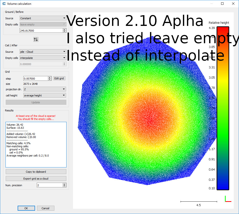

Humm... i am at a total loss
I tried the 2.10 latest release and i did the same thing with the Pile cloud again.
I cannot produce your results.
I get again the sparse error and a totally wrong result again.
Preview shows dots instead of a nice smooth clouds surface
Does this get calculated on the GPU?
Running on: AMD RX580 GPU, CPU AMD RYZEN 7 1700 "latest drivers installed"
Edit: on March 9th i tried it on a different pc. I'm still getting sparse cloud error.

Re: Calculated volume in 2.5 d changes with grid step size bug?
I finally found the issue! The strategy to fill the empty cells for the 'ceil' cloud was ignored. Only the 'ground' one was used.
I've updated the online 2.10.alpha version.
Thanks for the feedback ;)
Thank you for all your amazing hard work!
It's working now!
It's working now!
