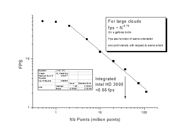

Now, using my old Geforce 540m, I explored the scaling between point cloud size and VRAM (as shown in the console). Here is the graph:

And the following graph shows the scaling of fps with point cloud size.
I've not tested on my workstation with a more powerful card, but somehow I expect the scaling in Npoints^(-0.75) to hold for any card...

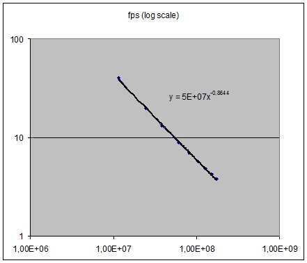

Impressive!
Here is my (modest) contribution to this study. I used a blank cloud. My card is a GTX780 with "only" 3Gb VRAM. The 3D view display resolution was 1200x800:
With a log scale, I get a -0.86 exponent (but of course that's not the same setup):
P.S.: ok to share a big cloud as BIN file (do you have one? ;). My biggest "public" cloud is Bremen's Schlachte (173 M. - the one I used for this test). source: http://kos.informatik.uni-osnabrueck.de/3Dscans/ (but not as a BIN file). We could also get big LIDAR datasets.
