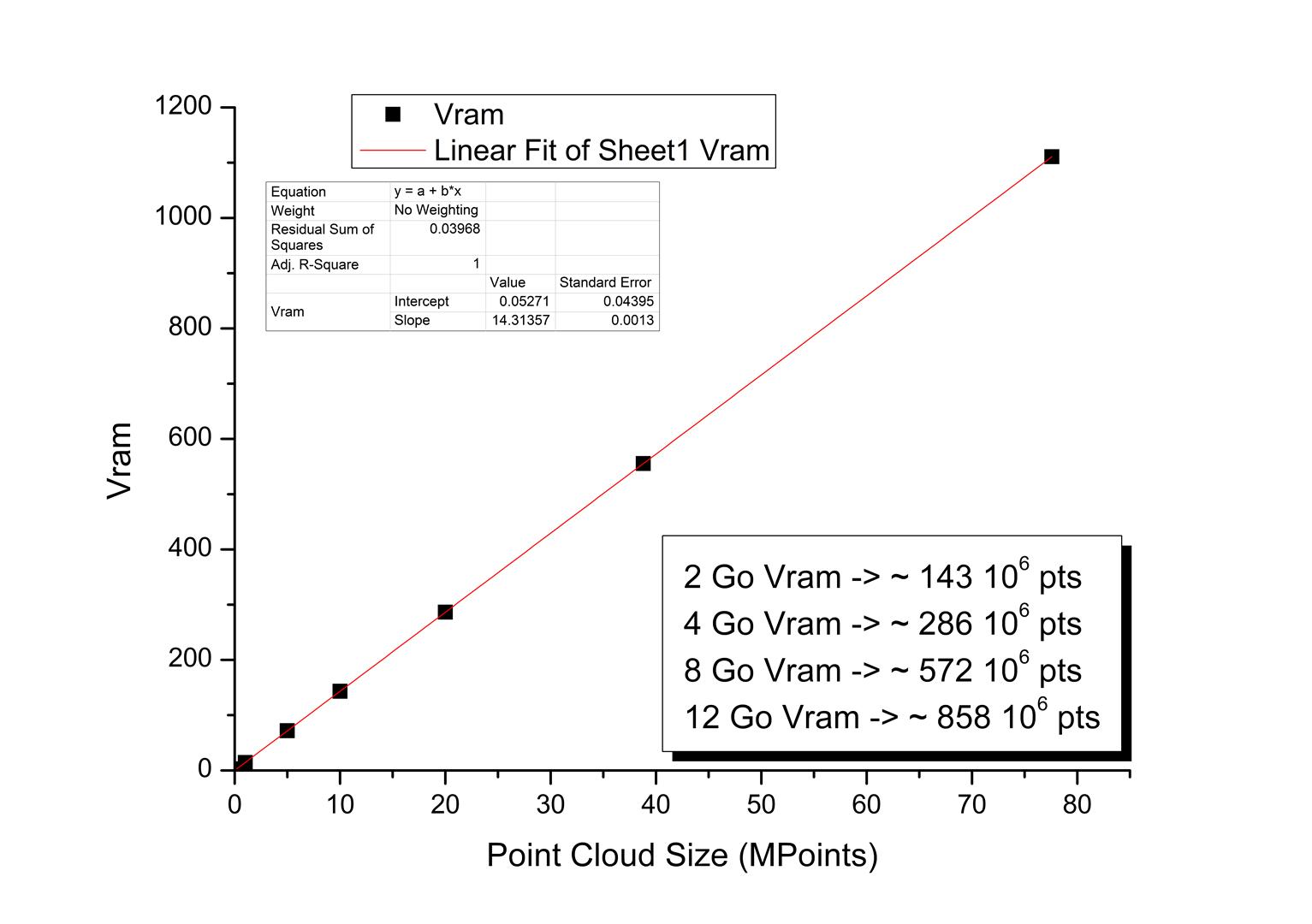

Now, using my old Geforce 540m, I explored the scaling between point cloud size and VRAM (as shown in the console). Here is the graph:
Vram_versus_PointCloudSize (Large).jpg (99.27 KiB) Viewed 37017 times
This shows how many points you could load on the best graphics card around (typical gaming cards can have up to 8Gb vram now).

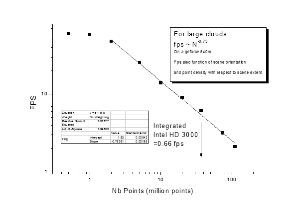

And the following graph shows the scaling of fps with point cloud size.
I've not tested on my workstation with a more powerful card, but somehow I expect the scaling in Npoints^(-0.75) to hold for any card...

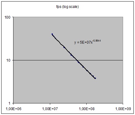

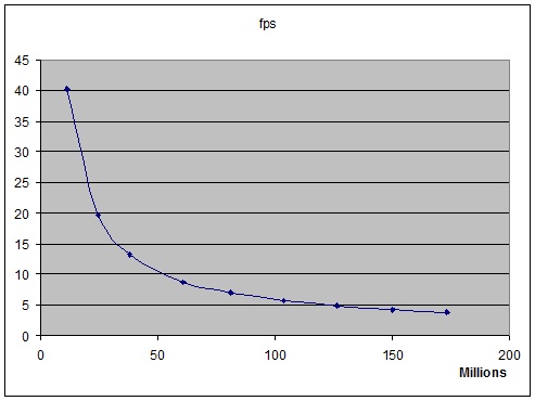

Here is my (modest) contribution to this study. I used a blank cloud. My card is a GTX780 with "only" 3Gb VRAM. The 3D view display resolution was 1200x800:
With a log scale, I get a -0.86 exponent (but of course that's not the same setup):
P.S.: ok to share a big cloud as BIN file (do you have one? ;). My biggest "public" cloud is Bremen's Schlachte (173 M. - the one I used for this test). source: http://kos.informatik.uni-osnabrueck.de/3Dscans/ (but not as a BIN file). We could also get big LIDAR datasets.
