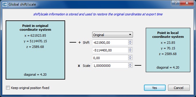

  • a new dialog, hopefully clearer and that can works in both ways (i.e. either when loading a file or when editing the global shift/scale information). It can be used on one or several clouds at a time. And I even implemented the option to keep the "true cartographic coordinates" constant.

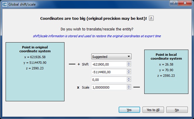

Here is the what the dialog looks like when loading a file (the combo-box let the user choose between the current suggested values, the previous one - if any - and the ones found in the 'global_shift_list.txt' file). When the user edit the shift/scale information, the 'original' and 'local' point coordinates are automatically updated so as to get an idea of the result:

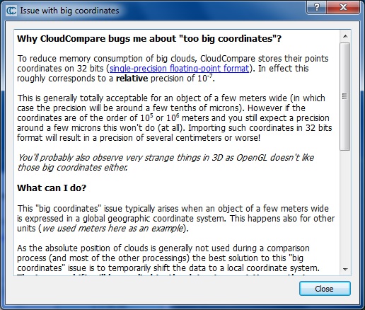

You can get more information by clicking on the "?" icon by the way :
Here is what it looks like when editing the global/shift scale information afterwards (you'll notice the "keep original position fixed" checkbox). This dialog will also appear (with small differences) if the user applies a transformation that makes the cloud go out of bounds:
