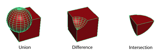

Hello !
Would it be possible to add some boolean operations (Union, Difference, Intersection) with meshes.
Thanks :)

That's funny because I recently tested at work a very nice library for performing boolean operations on meshes (cork: https://github.com/gilbo/cork).
My only concern is about the 'Cloud' in CloudCompare... CloudCompare is not really a meshing tool. What about MeshLab? Can it do this kind of stuff?
If you convince me that MeshLab can't (properly) do it, I'll integrate Cork in CloudCompare ;)

I have tried MeshLab that it can do some boolean operations, but the actual effect is not very well. So I really hope this function can be added to CloudCompare. Thanks very much.

I'll add this to the TODO list. Can't say when it will show up however!

Ok, CC has now a CSG-capable plugin based on the Cork library:
http://www.cloudcompare.org/doc/wiki/in ... PluginCork
The latest release (2.6.0) now incorporates this plugin.
