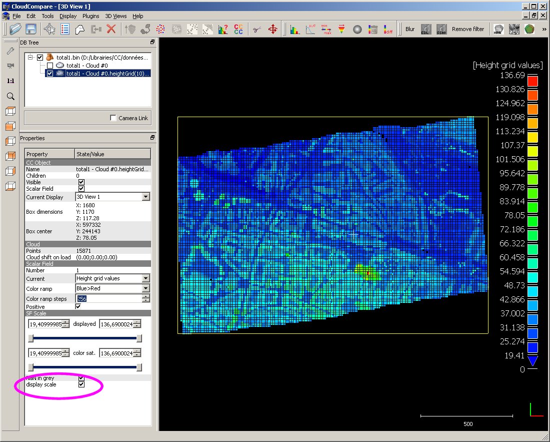

I forgot something:
Once you have a scalar field, check the 'display scale' checkbox at the bottom of the cloud 'Porperties', in the 'SF Scale' section (left side of the screen). See attached example.
Daniel
Daniel

Re: Scale display in height ramp
Ok thanks, it works well.
Yan
