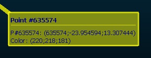

The Point Picking tool display box in Version: 2.5.3 [Windows 64 bits] should show # "point number"(x,y,z) values but instead displays the # "point number"("point number",x,y). The point number is displayed instead of the x value and x value instead of the y value and y instead of the z value.

My bad, you were referring to the simple point picking tool which spawns "2D labels"... I acknowledge the bug ;)

Should have added a snapshot to make it clearer!

This one just got me. It appears to affect both the label and property display of points and vectors picked with the simple point picking tool. I don't presently see a way to get the actual coordinates of my vectors.

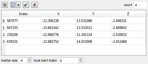

Have you tried with the "point list picking" tool?
Re: BUG Point Picking Display Box Values
Posted: Mon Mar 10, 2014 8:17 pm
by stevewillis
Yes, the "point list picking" tool works great. I use both tools, and have different use cases for each. In this particular case, I need to display the vectors that the simple "point picking" tool draws between pairs of points, and also need to get the x, y, and z offsets independently for these points. As a workaround, I exported the points in my cloud to an ASCII file, and then just looked up each point in my vectors from that file by point number.
