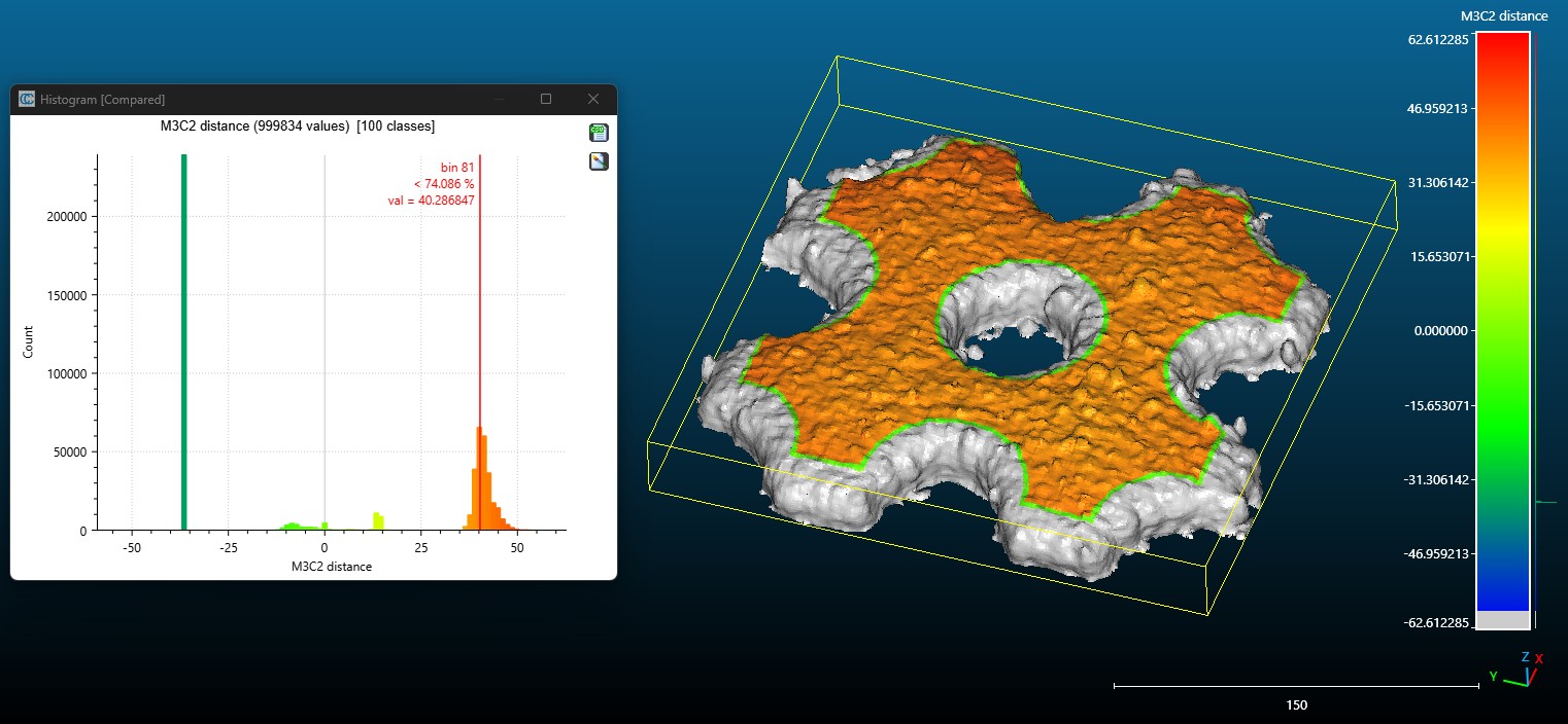

And for the records, here are the results with the M3C2 plugin:
(so about +40units for the top points, and -36units for the bottom points)
