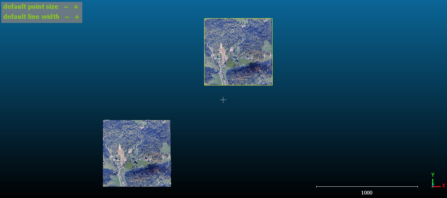

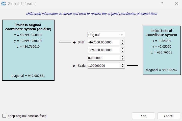

- I have two clouds with the same global shift (IMG01)
- Cloud 1 is reference cloud, coloud 2 is the one that needs to be aligned.

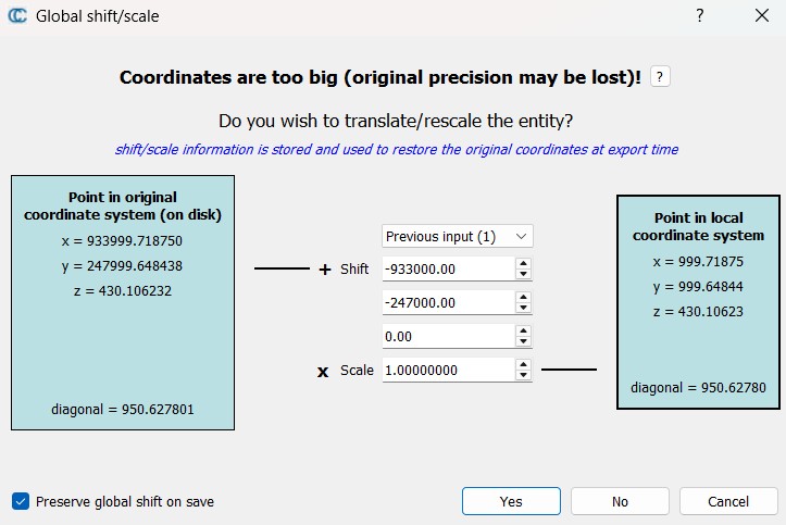

- I get weird data about the point in the original coordinate system and unlogical values in the right box (Previous input 1 option).

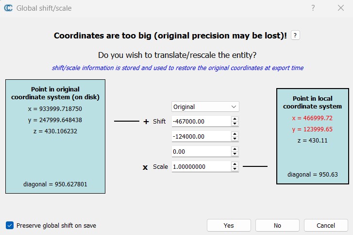

- I get weird data about the point in the original coordinate system and unlogical values in the right box (Original option).
- When I preform the transofrmation, clouds are not aligned.
