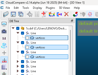

crash on merge 3 poly line points
Posted: Mon Aug 25, 2025 7:53 pm
by DA523
Screenshot 2025-08-25 224958.png (34.35 KiB) Viewed 33003 times
atatched dxf file

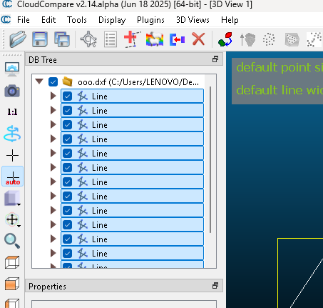

Screenshot 2025-08-25 230936.png (43.64 KiB) Viewed 32994 times
also if sample many polylines ...cc crashs
Re: crash on merge 3 poly line points
Posted: Mon Sep 01, 2025 9:26 pm
Good catch! The first issue was already fixed in a more recent version of CC (merging polylines is actually not possible). But the second one was another bug. I've fixed it normally (see the latest 2.14.alpha release for Windows).
