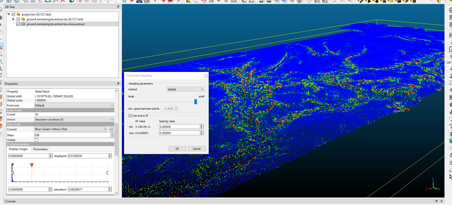

Please explain what the spacing value sub sampling of the scalar field is responsible for. It's not entirely clear from the link what they're responsible for. After trying some options, it was not possible to achieve the desired result, as per the link guide. Do you have any experience with such sub sampling? Is it possible to perform thinning on the roughness field?
Re: Thinning by characteristic relief points (identification of elevations and low points)
It's a linear model that maps a given sampling value 's1' (e.g. the minimum distance between 2 points if you have selected the spatial mode as in the screenshot) to the minimum scalar field value, and another sampling value 's2' to the maximum scalar field value.
For any point with scalar field value 'v', the sampling value will be s1 + (v - vMin) / (vMax - vMin) * (s2 - s1).
If you have a scalar field that goes from 0.0 to 10.0, and you assign a minimum distance of 50 for sf = 0.0, and a minimum distance of 5 for sf = 10.0, then the minimum distance will be 50 for sf = 0.0, 5 + 45 / 10 = 9.5 for sf = 1.0, 14 for sf = 2.0, ..., 50 for sf = 10.0
