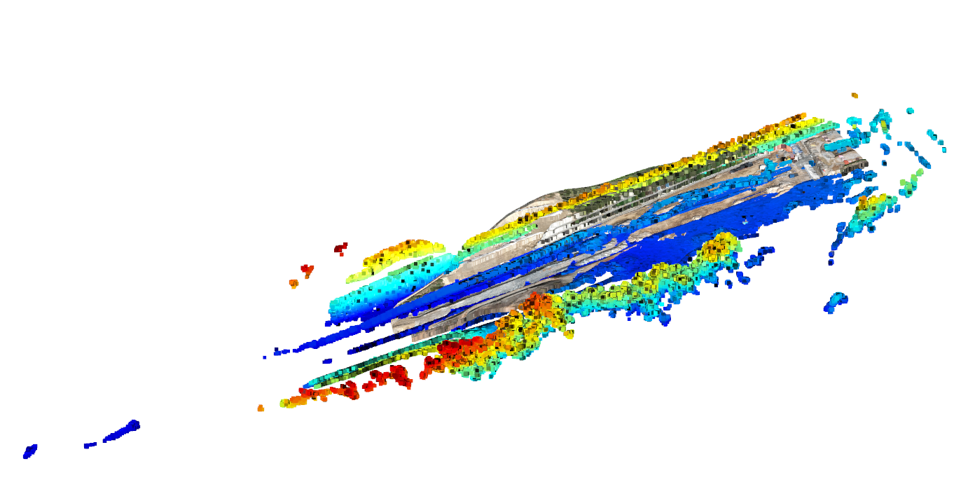

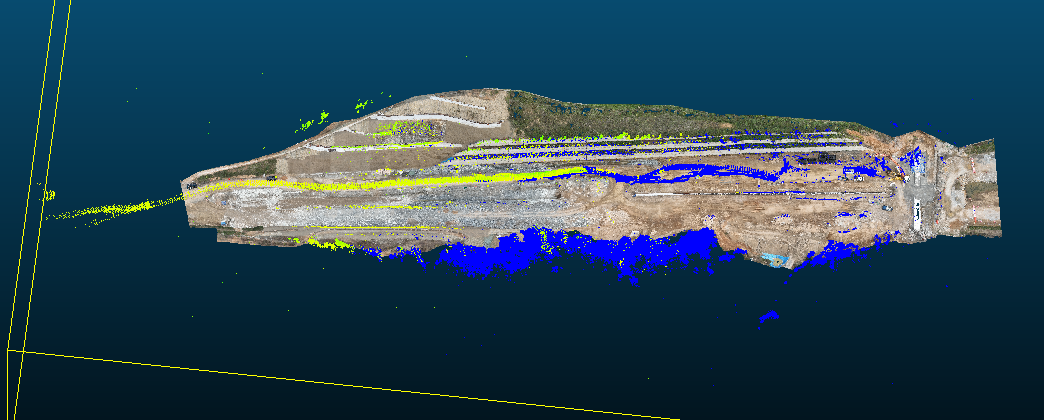

I got good results (qualitatively) with fine registration with 50% final overlap using CloudCompare. I would like to use the same results for my project. Is there a special pipeline?
It seems to be very fast with autoscaling (I didn't select any scaling options).
The pictures show the results using Open3D and SGD-ICP and the results using CloudCompare.
Thanks.
Re: How can i use fine registration(including final overlap) in my project?
By pipeline, do you have a context in mind? C++ project? Python?
If C++, then you just need to use the CCCoreLib library, and use the ICPRegistrationTools class. You can look at how it's used by CloudCompare here: https://github.com/CloudCompare/CloudCo ... ls.cpp#L46
If Python, they you could use the CloudCompy project (https://github.com/CloudCompare/CloudComPy).
