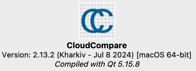

Hello CCers:
I'm running CC on a Mac with M1 silicon.
Attachment 0.jpg (31.51 KiB) Viewed 48498 times
A function related to specifying the center of rotation appears to not be working.
Double clicking does not cause the COR to change.
Any advice on why or how to fix this?
Sincerely,
Ken
Re: Double Click to Specify Center of Rotation not working on Mac
Posted: Mon Mar 10, 2025 12:28 pm
Sadly many things are different on macOS... hard to tell. Also, make sure there are some points below your mouse cursors (but I guess it's the case).
