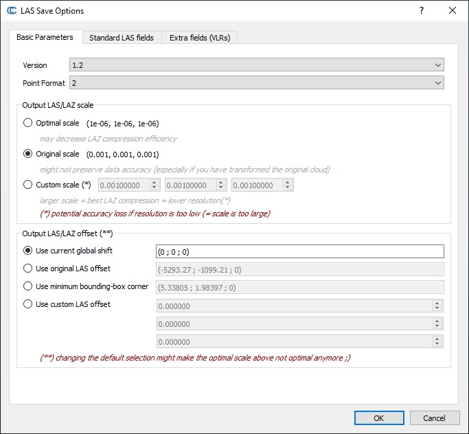

Re: LAS metadata (offset) modification
Posted: Sat Sep 14, 2024 1:08 pm
Ok, I've modified a little bit the algorithm to choose the 'best' LAS offset, but I also gave all the info and options to the user!
You can test that in the latest 2.14.alpha version (for Windows).
