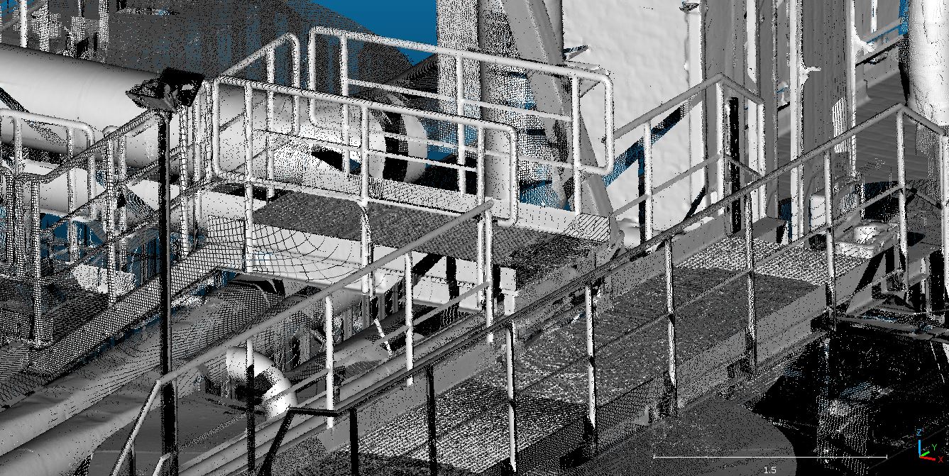

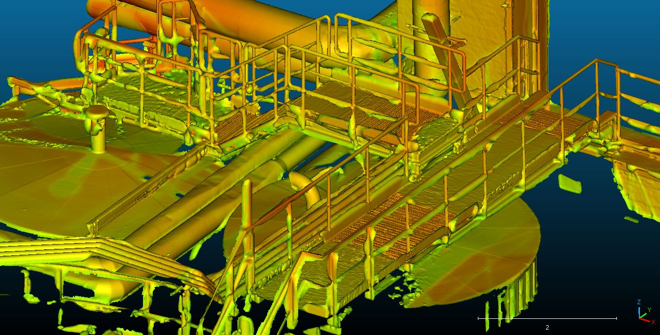

I have a point cloud containing grating floors with railings, and I'm trying to create a nice-looking mesh, but after a few hours of playing around with the options, I can't get a satisfactory result. I'm quite new to CloudCompare, and I was wondering if I'm missing something. Could it be related to improperly computed normals (local surface = triangulation, orientation using minimum spanning tree with knn=8)? I've tried different settings, but none are satisfying. After reaching octree depth 11, the difference is barely noticeable. Is it possible to achieve better results in this case? I was thinking about segmenting different objects and working from there, but I'd prefer to avoid that if possible.
1. Point cloud
2. Point cloud with normals
3. Mesh - Normals (local surface = triangulation, orientation using minimum spanning tree with knn=8), filtered scalar mesh from PoissonRecon, octree depth = 12 with default advanced options.
Cheers.

For an object like that I’d say your mesh actually looks pretty good.
Something like that is going to be difficult to get a clean mesh from. In addition to good normals you’ll also need an extremely dense point cloud that captures the entire surface with no gaps, which is hard to get with structures like the railing that introduce lots of occlusions. The mesh floor grating is going to be even worse and a tripod lidar scanner won’t capture enough detail on the individual grids to be able to mesh them as anything other than a rough surface.

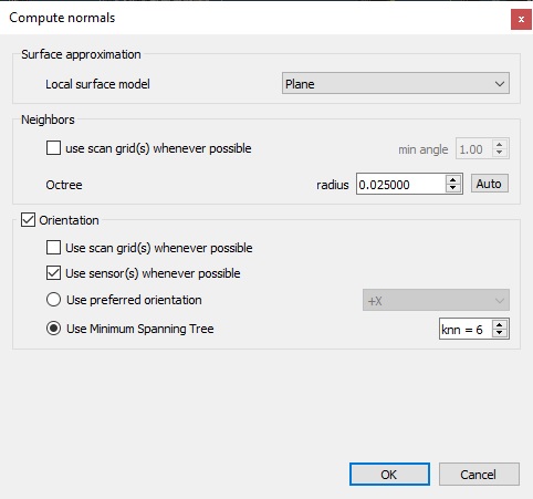

You can use the following parameters (on each cleaned individual scan). The important thing is to not use the scan grid:
Of course if you have a lot of memory you can load all the clouds at once and call all these tools on the 8 scans at once.
It should give you quite clean normals:
Eventually, you can merge the cleaned clouds with normals and compute the mesh with PoissonRecon.
However, you'll need a very high depth/octree level to reach this level of accuracy. And play with the resulting mesh 'density'. Still, I see that not all the bars are reconstructed properly (probably because there's not enough point on one side):
(I only reconstructed a small portion of the cloud here)
