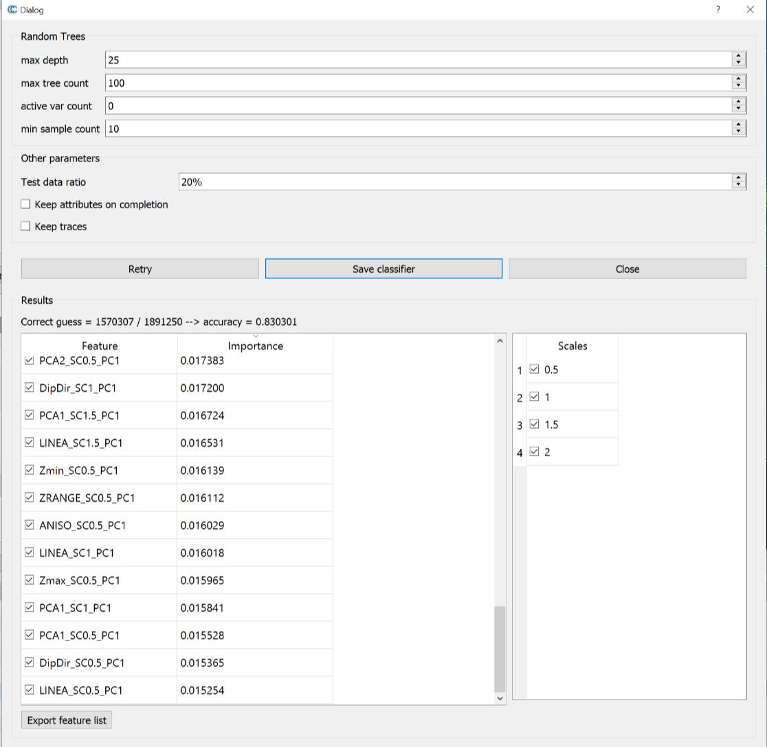

I used the following settings,
Max depth: 25
Max tree count: 100
Active var count: 0
Min sample count: 10
Scales: 0.5:0.5:2
Max depth: 25
Max tree count: 100
Active var count: 0
Scales: 0.5:0.5:2

Please provide the initial parameter file.
Did you launch the training on the overall dataset at once?
Re: Error when loading classifier
I launched the training on the railway_000033.laz file at once, without using a subset as core_points.

I launched a training with the same parameter file and the same Random Trees dialog parameters. The classifier is quite large, about 700Mo, but not as much as yours. I can load it after to classify other points. Are you sure about your configuration?
