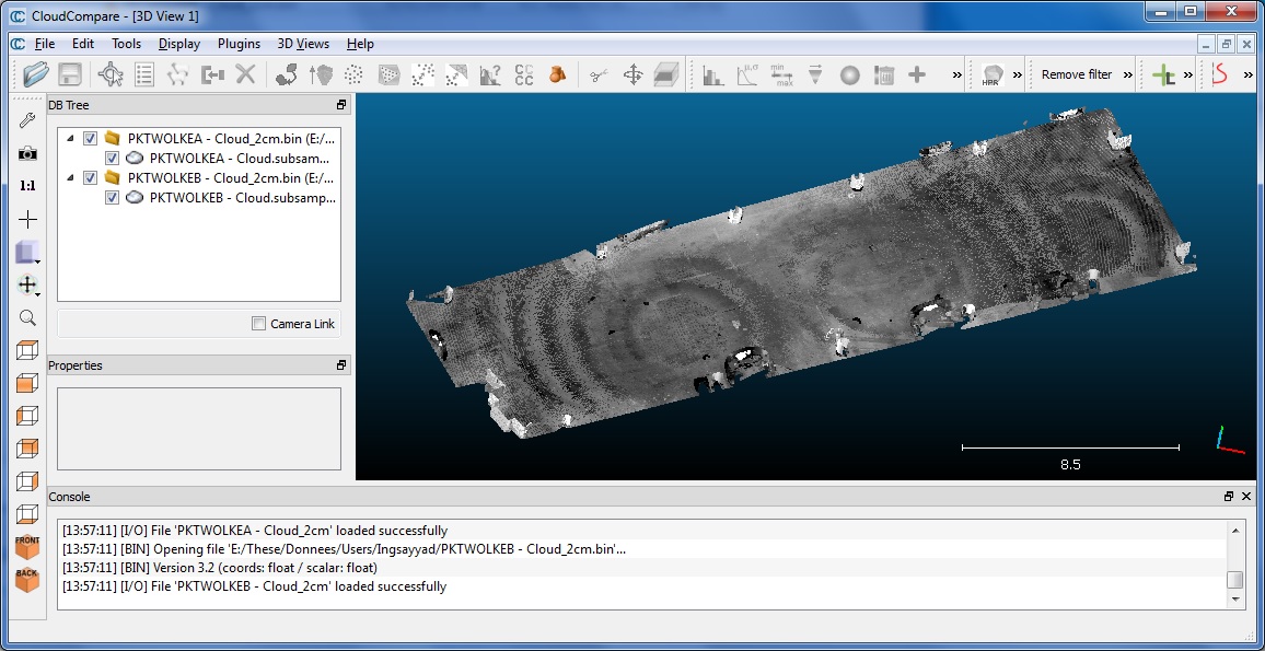

I need to comapre two scans.
I 'm getting strange results. Infact there shouldn't be any difference between these scans.
  • Why I 'm getting rings around scanner stand positions.
    What is best way to compare these scans.

Interesting.
Looking at the shape of these rings, I doubt this is a bug or a numerical artifact. Maybe something in your measurement process?

Thanks for the dataset.

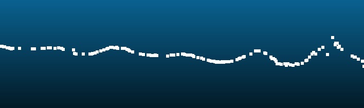

And I confirm that the ripples are already present in the data (you can see them directly after loading the data, even without computing any distances):
When you make a slice of one of the cloud and multiply the z scale by 10 you can clearly see the oscillations:
Zoom x10
Zoom x10
It must come from the measurement process. However I won't be able to help you much more as I'm not an expert in the scanning process. Maybe you could ask to the manufacturer?
