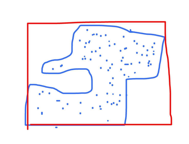

Most of the time, but not all the cases, optimum volume and area is when % of matching cells is close to % of shape area to area of containing rectangular (min x min y, max x max y)
and it is tricky
You can use try and error or visual inspection
Usually, you start with samll grid and increase till you get constant volume

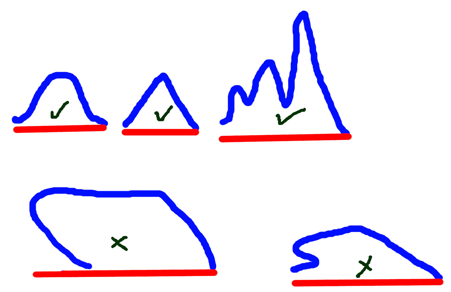

2.5d volume has limitations
Please check the attached example where 2.5d volume fails because 2 z levels in the same pointscloud
real volume=2.964 cubic units
Screenshot (308).png (90.41 KiB) Viewed 17926 times
2.5d volume fails.zip
(1.38 MiB) Downloaded 1578 times

Easy to understand,
Does this mean that the calculation will be incorrect if there is an overlap between top and bottom?
Re: About Volume calculation Results
Posted: Tue Jul 09, 2024 5:25 am
by DA523
2.5d volume between red and blue pointsclouds
x means 2.5d volume incorrect
