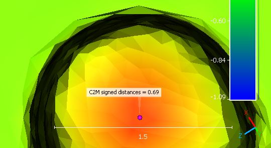

First, that's probably a detail, but since the radius of the hole is around 0.75 units, I think the distance of 0.7 units for the central part of the bottom of the hole is not inconsistent:
