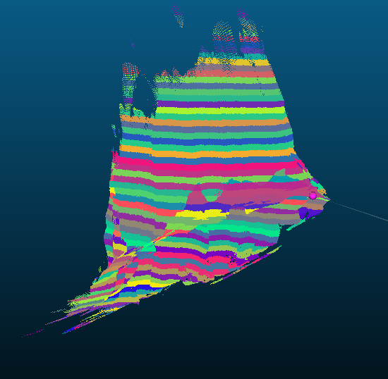

Is there a way to specify a width for multi slice extraction? I'd like to get 0.1 meter slices of my entire scan, but I have not seen a way to that that so far. Ive been able to extract slices with the "cross section" tool, but actually being able to extract slices at a desired width would be helpful. I'm not sure if there is another strategy for doing this either, but I want to calculate volume after creating convex hulls of each of the slices, so I need the width. Thanks!

Hum, not sure to follow you. With the Cross section tool, and it's 'repeat' mode, you can extract slices of a specified width, and even with an interval between the slices that's different from the slices thickness. And of course you can set the initial section position so that's its aligned with a specific coordinate. What other feature are you missing?
