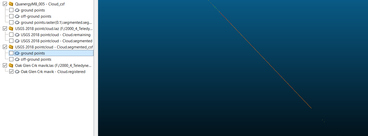

Cloud Point showing up as a straight line
Post by LiDoom »
For some reason when loading this point cloud file it shows up as a straight line, I can zoom in and out, but I don't see the full extent of the cloud.

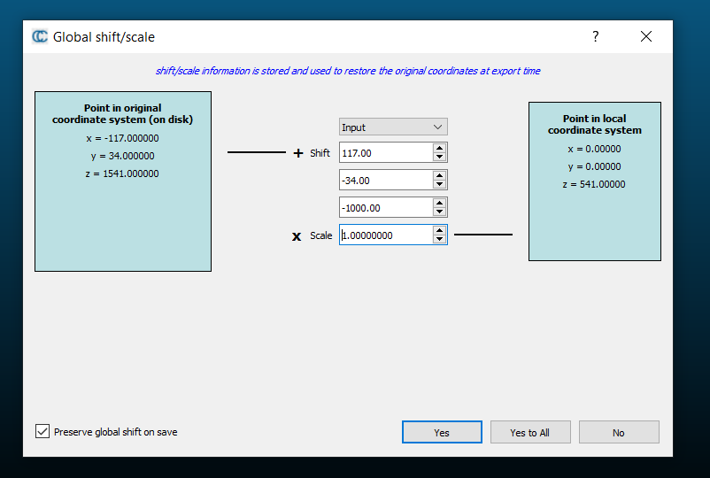

HeadLess wrote: Sun Apr 28, 2024 7:46 pm Make sure that you are using global shift during opening, if cc revommends it. It might be caused by large coordinate precision loss.
here's what I see when importing. For some reason I don't have an issue when opening up this point cloud in Quick Terrain Modeler.
Posts: 8244
Re: Cloud Point showing up as a straight line
And what the bounding-box looks like once you've loaded the cloud?
There's good chances that Quick Terrain Modeler does manage properly geographic coordinate systems...
