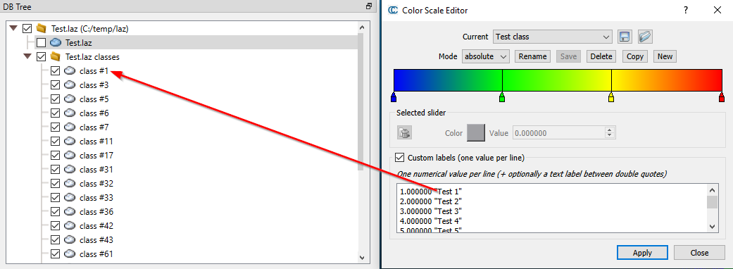

Is there any way to automatically rename the new classes of "Split cloud (integer values)" function.
I have created custom labels in the color scale manager and would be happy if I could assign the labels to the newly created classes.

My workflow:
1. Open classified Laz file
2. Activate custom color scale with color defintions and labels, convert SF to RGB
3. Split cloud (integer values)
4. Export each cloud with classification based colors and names as e57 for further use.
Thank you.

Wow... no it's not possible. And even by tweaking the code it wouldn't be that simple...
