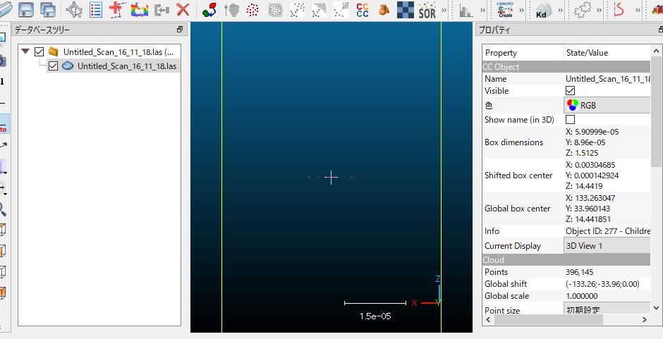

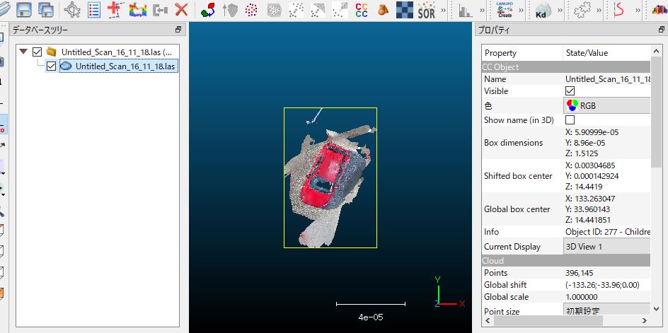

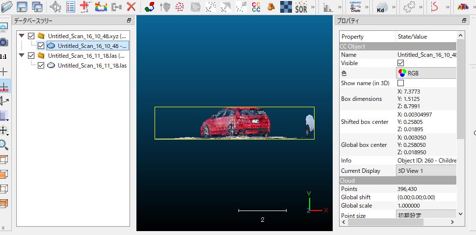

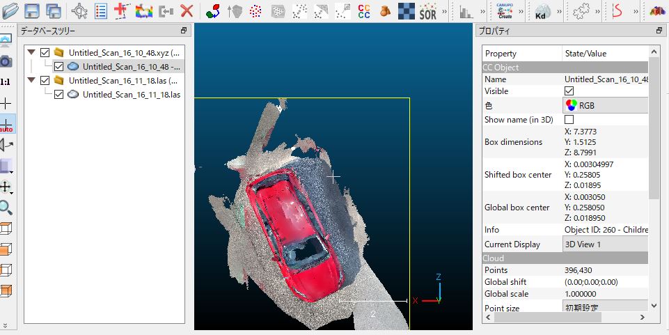

I captured the image using the 3D Scanner App on my iPhone and exported the point cloud. (GPS turned on)
The same data was output as two types of data.
・For CloudCompare (xyzrgb)
・Las Geo-Referenced(GPS Coords as long,lat,alt)
CloudCompare is fine.
Las Geo-Referenced has a low y-axis and extends horizontally.
I think it's a problem with the output of the 3D Scanner App.
Is it possible to correctly import Las Geo-Referenced into CloudCompare?
The first two are For CloudCompar. The next two photos are Las Geo-Referenced.
