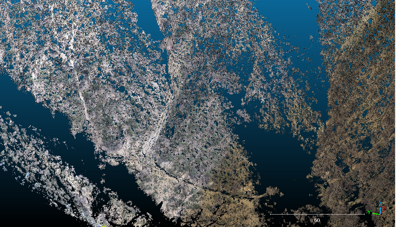

I am a student doing research on debris flows and have collected LiDAR data of a mountain side using a Teledyne Optech Polaris LiDAR. My goal is to remove vegetation from the mountain side in order to eventually calculate volumes of sediment, deposited or accumulated, before and after a storm. I have tried using many different software's to remove vegetation (e.g Atlascan, QT Modeler, etc.),but I have high hopes for CloudCompare. I was attempting to work with the CANUPO plugin until I stumbled across the new 3DMASC plugin. My question is would using the 3DMASC plugin be able to complete my goal of removing vegetation and leaving a 'bare earth model' of the mountain side?
Also if 3DMASC is the right way to go about this, where can I download the plugin and if someone can share the steps on how to set it up would be great!
I am running CloudCompare version 2.12.1. Thanks.
Screenshot 2024-02-04 114701.png (1.98 MiB) Viewed 11704 times
Re: Noob Help
3DMasc is part of the latest 2.13.beta version.
To remove vegetation, the options are, in order of complexity: CSF, Canupo and 3DMasc (see the plugins page: https://www.cloudcompare.org/doc/wiki/index.php/Plugins).
Sadly I am not an expert so I won't be able to help you much further. However, there are dedicated threads on this forum for the Canupo and 3DMasc plugins. Or you might try to contact the authors directly.

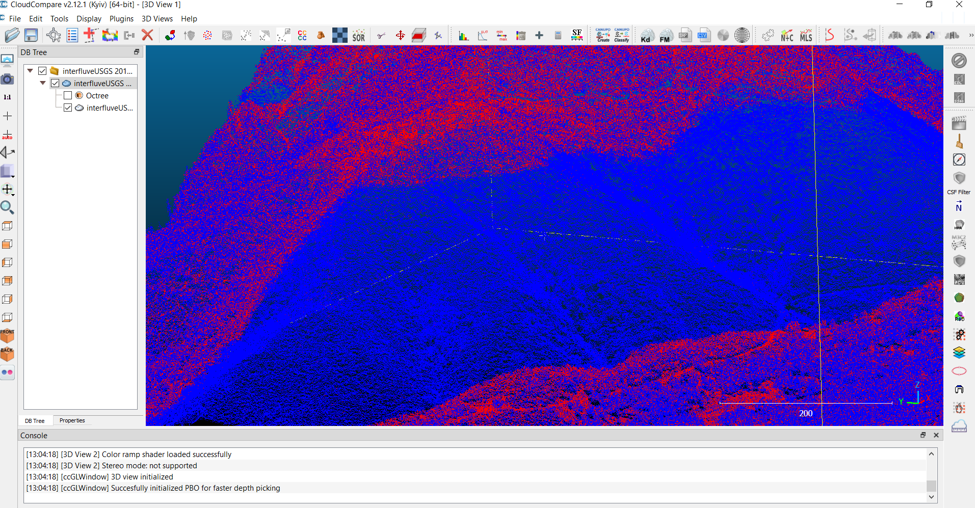

So I have loaded the vegetsemi.prm using the Canupo Classify Cloud tool and have generate the below screenshot. I did not create my own classifiers. Not sure what the next step is after this. How can I remove the vegetation from this point? Also why is there a blue "blind" spot on the point cloud?
Screenshot 2024-02-04 114701.png (595.28 KiB) Viewed 11612 times
Re: Noob Help
To segment the points you'll have to use the 'Edit > Scalar fields >Filter by value' method. And using a default classifier only makes sense if you have the same units as what was used to train it... Maybe it would be worth creating your own classifier?
