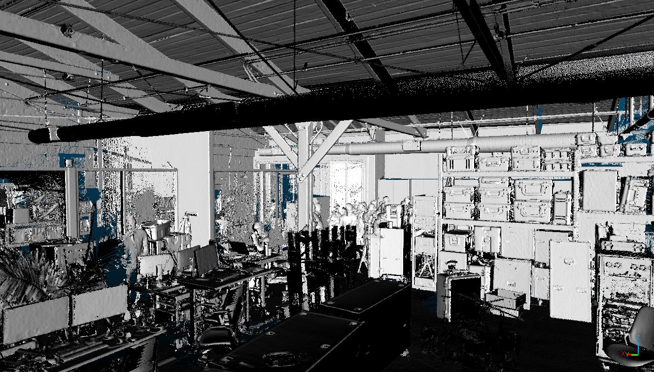

Ok, so I looked at the cloud, and it's pretty crowded inside the building!
There's also a single sensor defined in the E57 file, while there are clearly much more scans. This can be very misleading for CC.

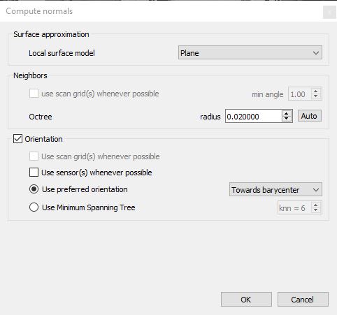

- I computed the normals with the following parameters:
(mind the fact that 'Use sensor(s) whenever possible' is disabled - instead I told CC to orient the normals so that they all point towards the center of the room, which is clearly a big approximation but probably more robust than the other heuristics in this case).

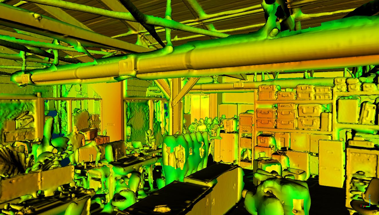

This gave decent results:
And you get a not so bad result with Poisson (considering the challenge ;):
