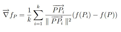

If you can read French you can refer to my PhD manuscript (https://theses.hal.science/pastel-00001745/)
Here is the formula:
P is the center point on which we compute the gradient, Pi is the ith neighbor. And f(P) is the scalar field value associated to the point P.

Thank you very much Daniel for your response and the formula. I can read French well enough, but unfortunately it is my lack of formal training in mathematical notation that is the problem. Would you mind explaining in layman's terms what the gradient formula is doing here? I really appreciate your help!
Re: Scalar Field > Gradient Formula?
The gradient represents how much the scalar field changes, and the 'main' direction of change.
So we sum all the unit vectors that point from the central point to each of its neighbors. Each unit vector is multiplied by the difference of the scalar values (between the central point and its neighbor). And finally we divide the result by the number of neighbors.
In CC we just keep the amplitude/norm of the resulting vector (not the vector itself).
