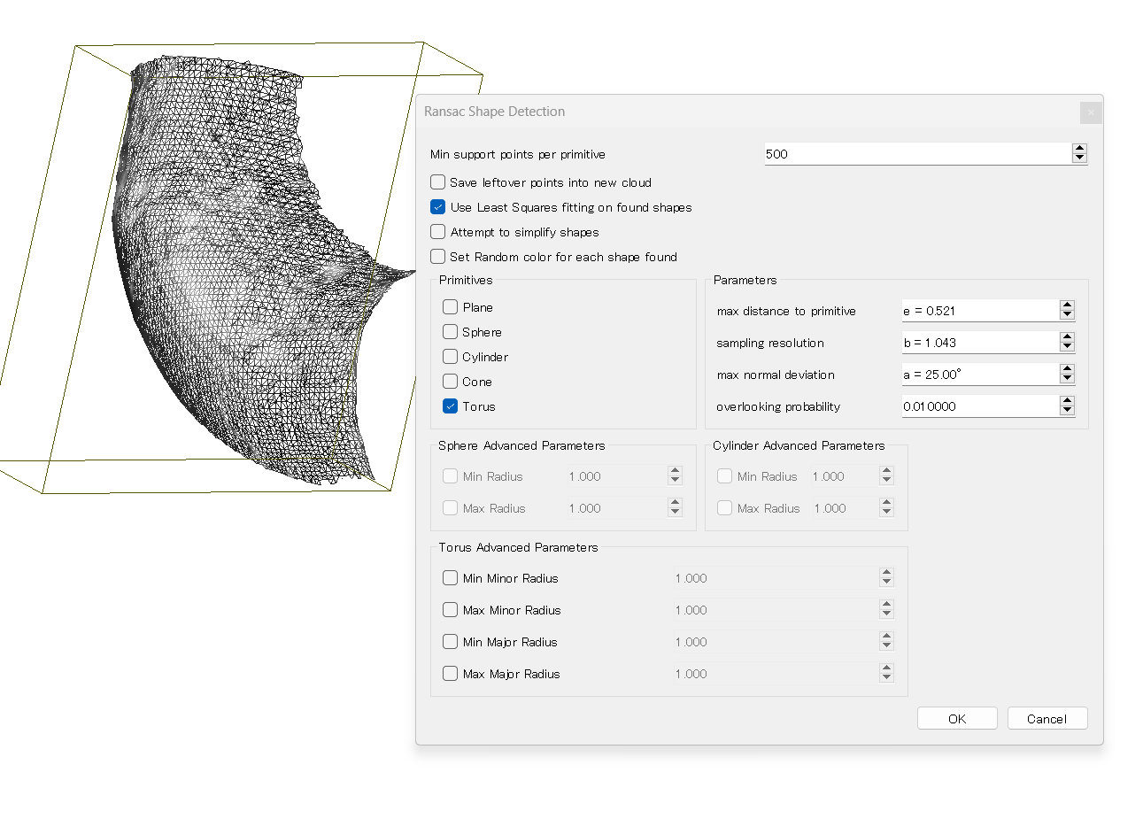

I am MINORU NIIMURA, working on 3D data measurement and analysis.
I have been using CloudCompare for more than 10 years now.
I tried to generate a torus to match with the measured elbow (part of pipe).
I got an error message "segmentation failed".
This error message appears for any other shaped that I tried.
segmentation failed for torus.png (164.54 KiB) Viewed 17165 times
Does anybody have an idea what is wrong with my settings?
I appreciate getting any hints.
Best regards,
MINORU NIIMURA, Tokyo, Japan
Re: RANSAC segmentation failed
Posted: Fri Jul 26, 2024 11:52 am
Do you have enough vertices/points in the selected cloud? Because a minimum of 500 points may be too much compared to the total number of points?
Otherwise, don't hesitate to send me the cloud (to [email protected]).
Posted: Fri Jul 26, 2024 12:57 pm
by MINORU NIIMURA
I will send you the 3D data (PLY format).
Thank you very much for your assistance.
By the way, I tried many different 3D data (PLY format) but all of them had failed, so your information.
Best regards,
Minoru Niimura
Posted: Fri Jul 26, 2024 3:37 pm
Thanks for the data.
I can confirm that it fails on my side as well when trying to detect a torus... I'll have to look at what happens at a lower level in the code. It may take some time.

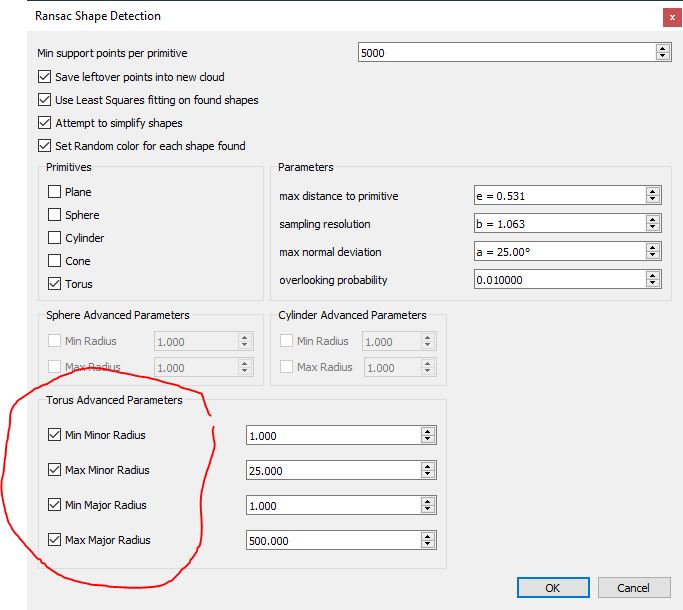

Posted: Sat Jul 27, 2024 11:28 am
So it seems that one has to set the min and max radius parameters to be able to extract torus shapes... I'll try to fix this in a future release.
Meanwhile, just make sure you specify some realistic values:
