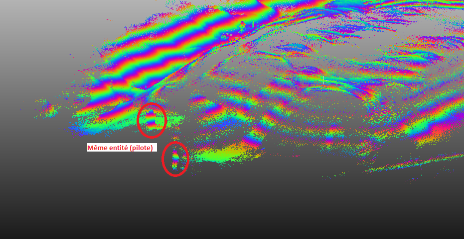

I have now another problem... It seems that, when I do a long flight with the drone, it sometime lost its way and I have for example two columns approximatively on the same place but with a small lag, instead of just one column. Is there in CC a correction for that type of issue ?

Attached to the reply, a picture of my cloud for a stockpile where I (the pilot) am taken twice into account in the cloud, due to a lag.

Hum, not sure to see how this could be fixed in CC!
