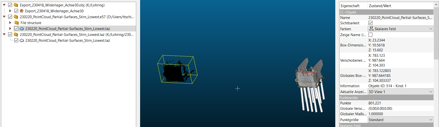

Using the Algine function (https://www.cloudcompare.org/doc/wiki/i ... itle=Align), I looked for more than three points in the incorrectly registered point cloud as well as in the correctly registered mesh, thus fitting the point cloud to the mesh. In the properties of the point cloud, it does now show a displaced Box Center as well as a Global Box center.

Point Cloud "Global Shift/Scale" while importing with "Point in original coordinate system (on disk) x=-11.015, y=12.208, z=12.628 which suggests a transformation of 100 in the x-direction will result in "Point in local coordinate system" x=88.9858, y=12.208, z=12.628. I do then apply Aligh Tools while picking three points on a mesh. This leads to a transformation matrix of

See the first Screenshot for the result of reimport into Cloud Compare.

So I finally had the time to look at this.
Only the coordinates/values of the 'Global box center' should matter. These are the values that will be exported. Most of the file formats support large coordinates (apart from STL files I believe). For the other, we always export 'Global coordinates'. The local coordinate system is only temporary and within CloudCompare.
If you export to LAS files, you can set the 'LAS shift', which is similar to CC's Global Shift in its principle. But whatever values you choose, the exported coordinates will be the same. However, when you re-import the cloud, you are not forced to use the suggested shift. You have to set the shift carefully when using different clouds so that the local coordinate system is the same for all clouds.

Re: export of aligned point cloud to mesh with geo coordinates
Hello Daniel,
okay, I am a step further!
To my process: I have exported 5 different qualities (Lowest, Low, Medium, High and UltraHigh) of this point cloud from Metashape. The first point cloud (high quality), with which I performed the registration, is showing the correct coordinates under "Global box center". The remaining four point clouds, to which I then applied only the transformation matrix, have only those of the matrix under "Global box center". I think this is where my problem lies.
