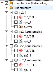

Yes, I am talking about the subsampling tool. What is that other child with the paintbrush next to it in your tree? Could that have something to do with it?
Re: Subsample .e57 cloud and then estimate normals with sensor
Posted: Sat Dec 03, 2022 11:31 am
No that's an image, and they are copied as well when segmenting or subsampling a cloud (as well as other types)
