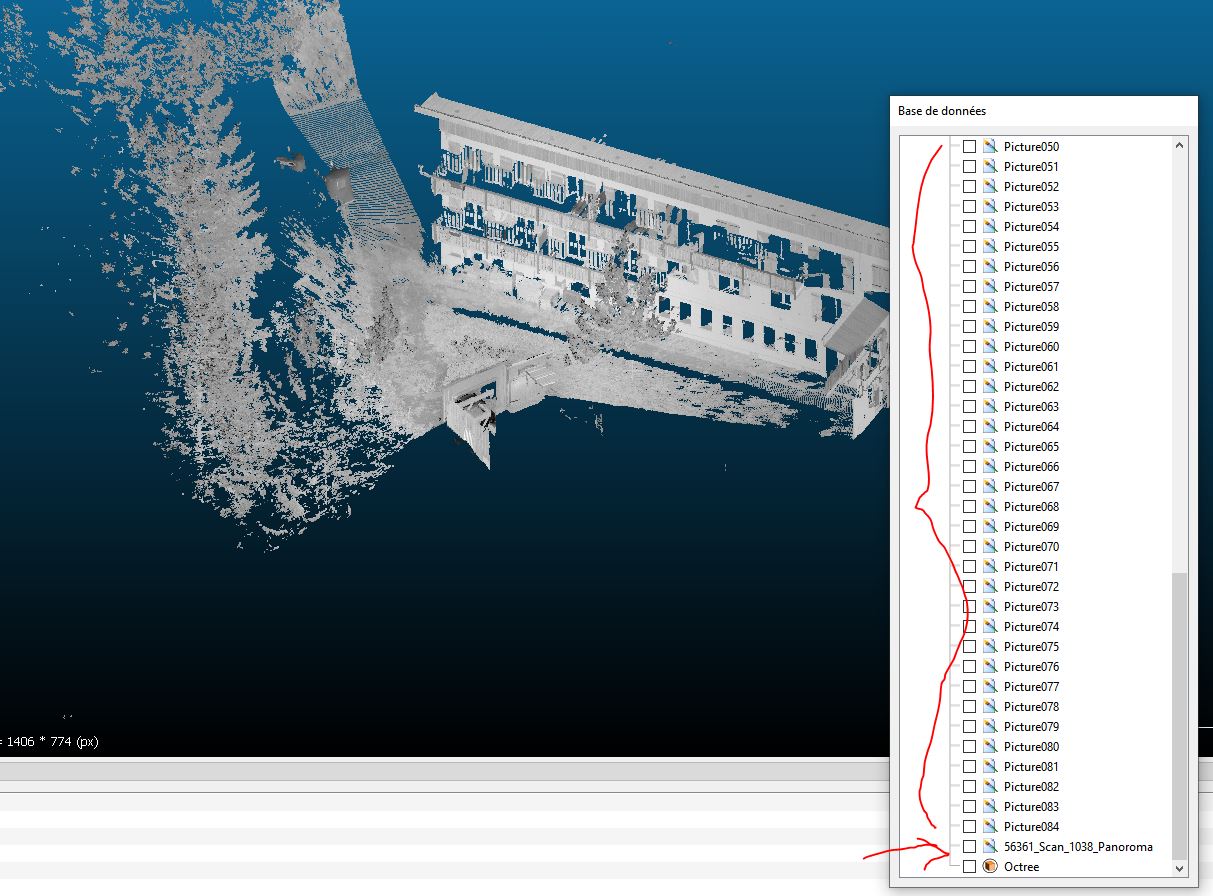

We have exported a raw FARO laser scanner station from FARO Scene in E57, with the pano image embeeded into the E57 file.
that file is 508Mo
that file is being imported into CC , the point cloud is present as well as pano image (broken down into native picture shots + pano image)
then I export again that file again in E57
now that file is 625Mo
Strange isn't it ?

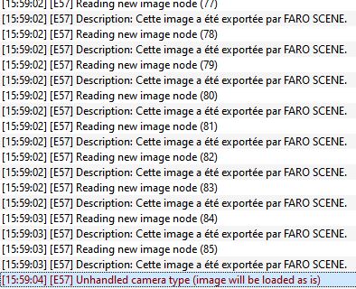

Just to let you know that the native E57 file that comes from FARO SCENE returns a warning in CC console
any idea why ?

So CC doesn't handle all sensor and camera types (so at least the warning is not unexpected).
