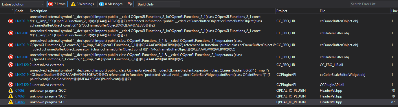

Since it appeared that the build was still searching for qLASFWFIO, I set -DPLUGIN_IO_QLAS_FWF=OFF and got a successful cmake. But building in Visual Studio 2019 resulted in 7 errors:
Screenshot 2022-10-24 112217.png (63.74 KiB) Viewed 8487 times

CMake Error at LASlib/src/cmake_install.cmake:122 (file):
  file INSTALL cannot find
  "D:/CloudCompare/LAStools-master/LASlib/src/../lib/MinSizeRel": No such
  file or directory.
Call Stack (most recent call first):
  cmake_install.cmake:37 (include)
I gather MinSizeRel is related to the Debug or Release installation type, but that is honestly over my head. I've tried building in Visual Studio separately with the Release configuration (since build in VS code seems to default to Debug). Both configurations result in the same CMake error.
Thanks in advance for any insight!
Paul
