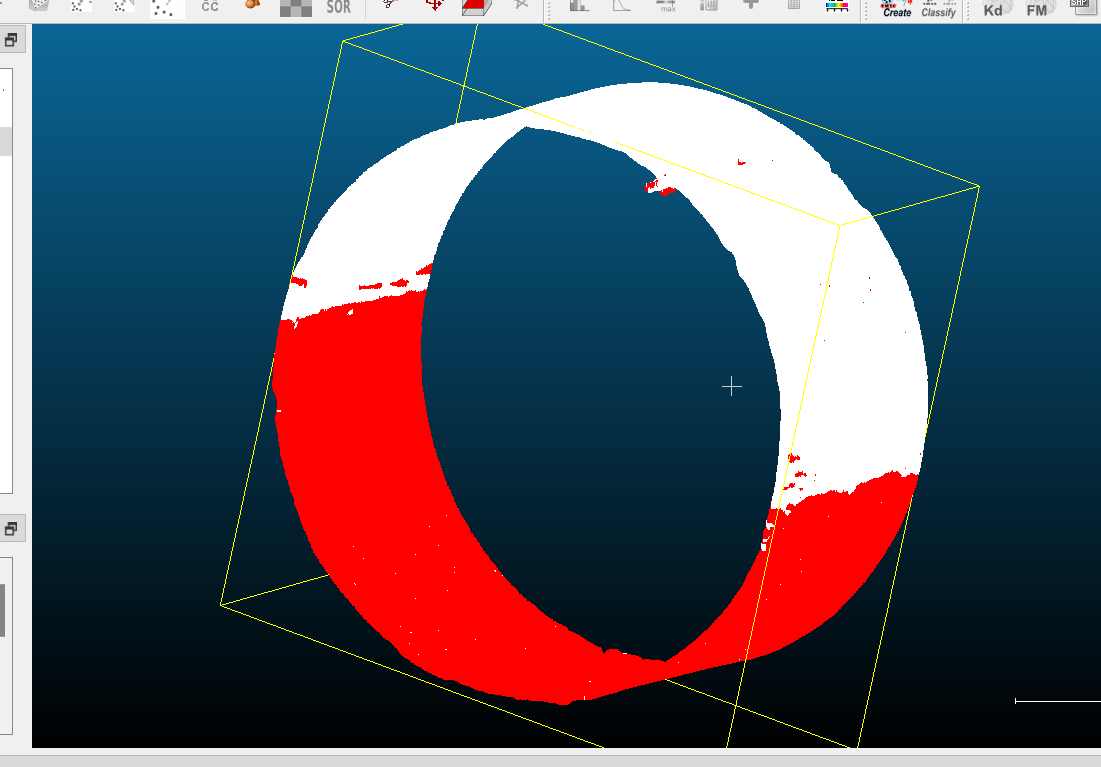

cntl+t
rotate around Y by 90
calculate normal
normals to SF
filer by SF 0 to 1
find volume between the 2 new parts
it is around 157 cu
another way is to use Poisson meshing then fit -facet etc ...
Using Blender can help a lot
Screenshot (10).png (46.15 KiB) Viewed 5901 times
