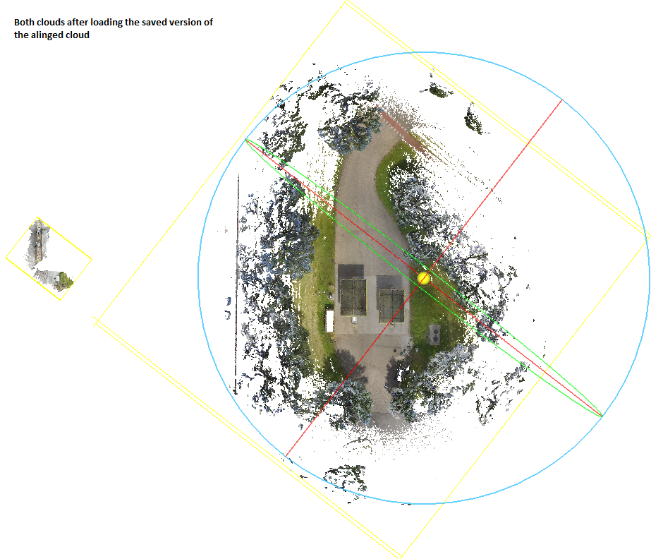

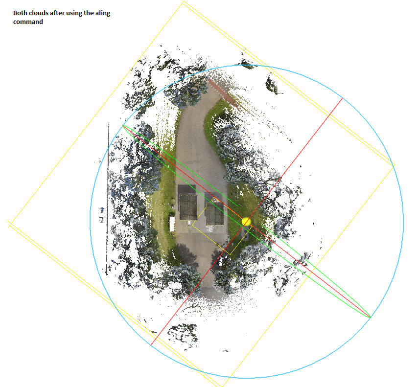

putting the global shift to 0,0,0 did something bit it is still not on it's place.
let me explain a little more what i am trying to do.
i have a geoslam pointcloud made in the dutch coordinate system.
Now i Also made some pointclouds with the Iphone Lidar.
These Iphone clouds are not on the proper position and rotation.
I want to relocate the iphone clouds to the right position by using the geoslam cloud as a the leading pointcloud.
So i first loaded the geoslam pointcloud as a leading cloud for the positioning and moved and rotated the Iphone clouds to the correct location.
After saving the location of the iphon cloud is back to the original location.
and if i set the global shift to 0,0,0 it is getting closer. but still not on the right location when i load the saved version of that cloud.

I tried both options on the Iphone cloud. but it did not work.
i also tried it on another cloud that was not made with the Iphone. and that worked great.
