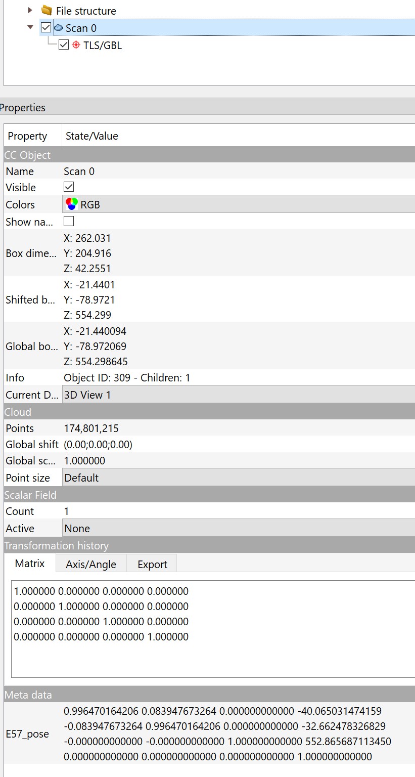

Hello, I can't find the way to export all the data [TLS / GBL Sensor] of all the clouds at the same time, is there a way? Basically I would like to obtain an x, y, z file with the scan center locations of each cloud contained in a CloudCompare file. Thank you.

Hum, sadly there's no way to do it currently... Apart if you hack the code of course (or maybe via Python and CloudCompy?)
