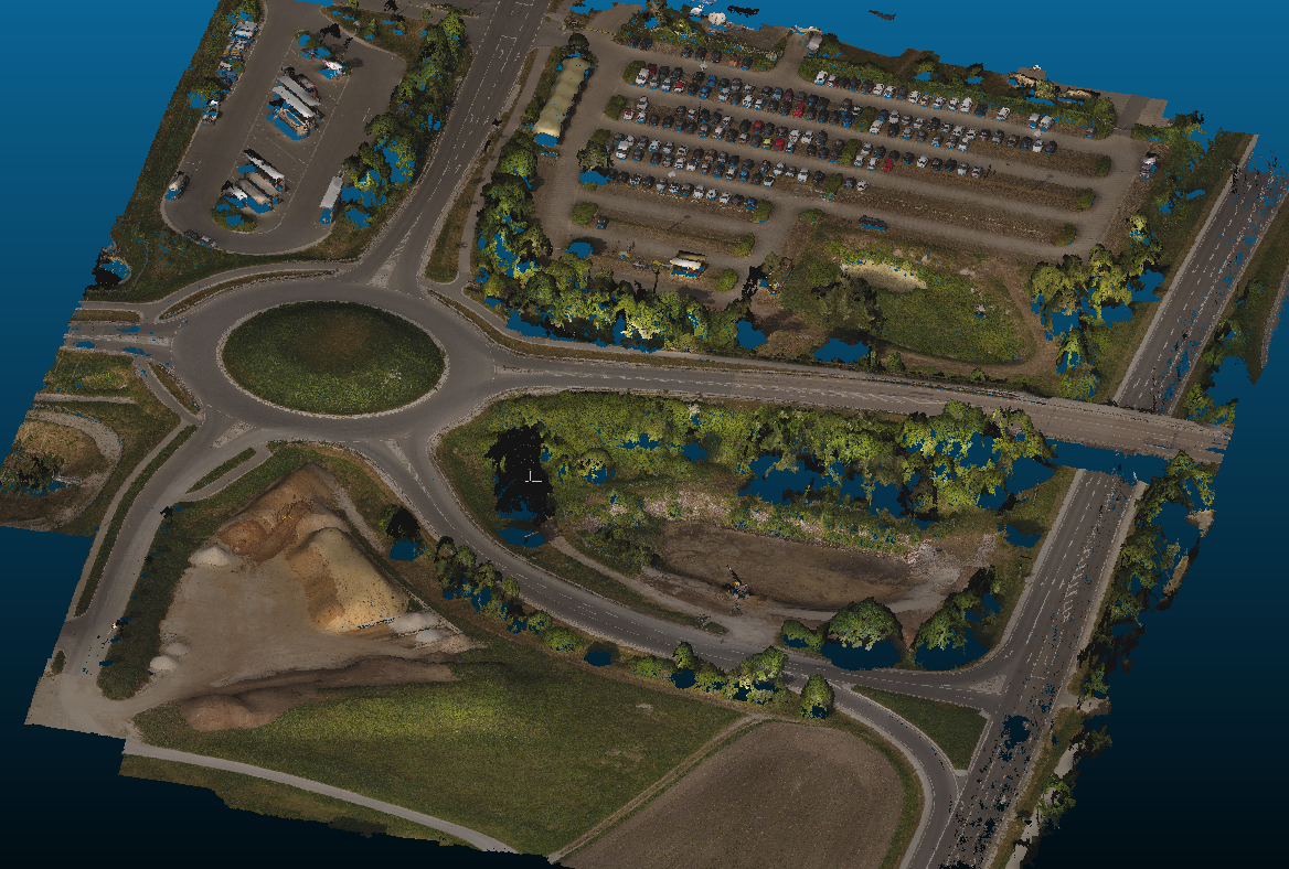

I have a point cloud from a drone flight (see picture 1).

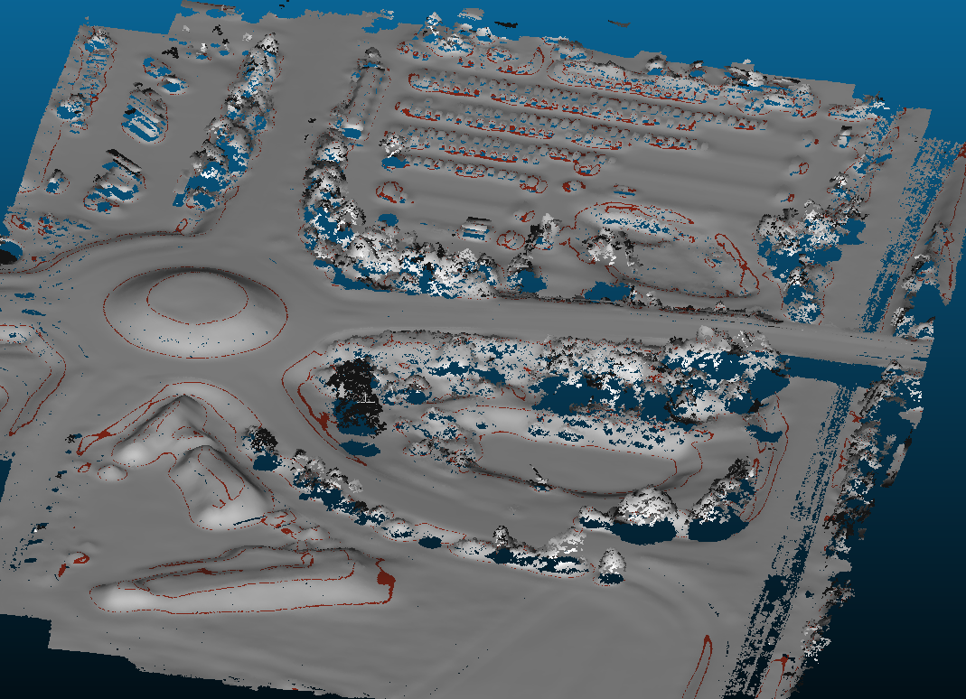

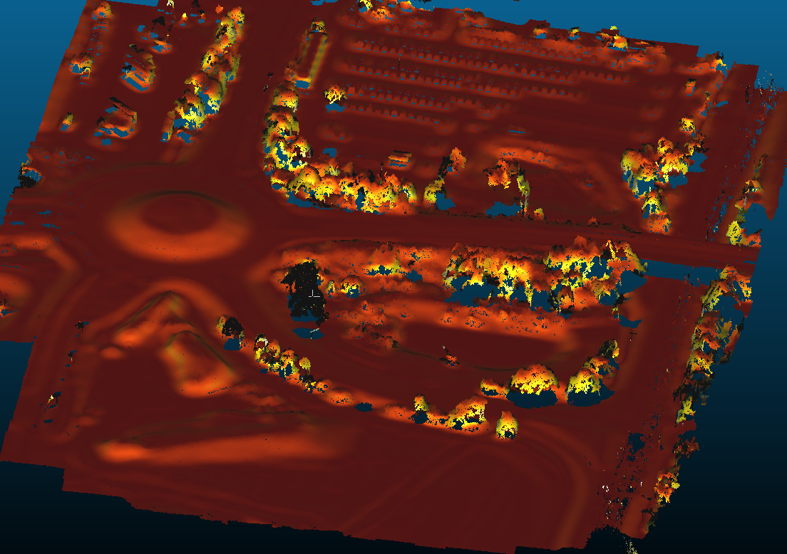

With "Edit" -> "Normals" -> "Compute" -> "Convert to" -> "Dip/Dip directions SFs" (see picture 2) and the slider I find manually the points of the break edges (see picture 3).

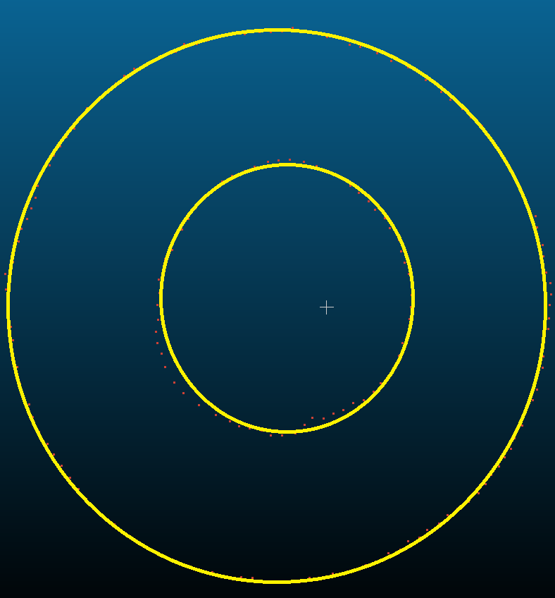

I then export them and "subsample" as needed (e.g. every 1 m) and "segment" different areas. (see image 4, e.g. a pile of dirt, traffic circle).

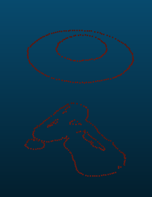

These points I would like to have now either as a polyline or many individual lines, each between 2 points, connected (see sketch image 5) and finally export to CAD that I then get clean edges during further processing and do not have to draw these lines manually.
