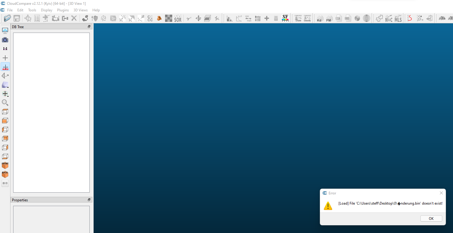

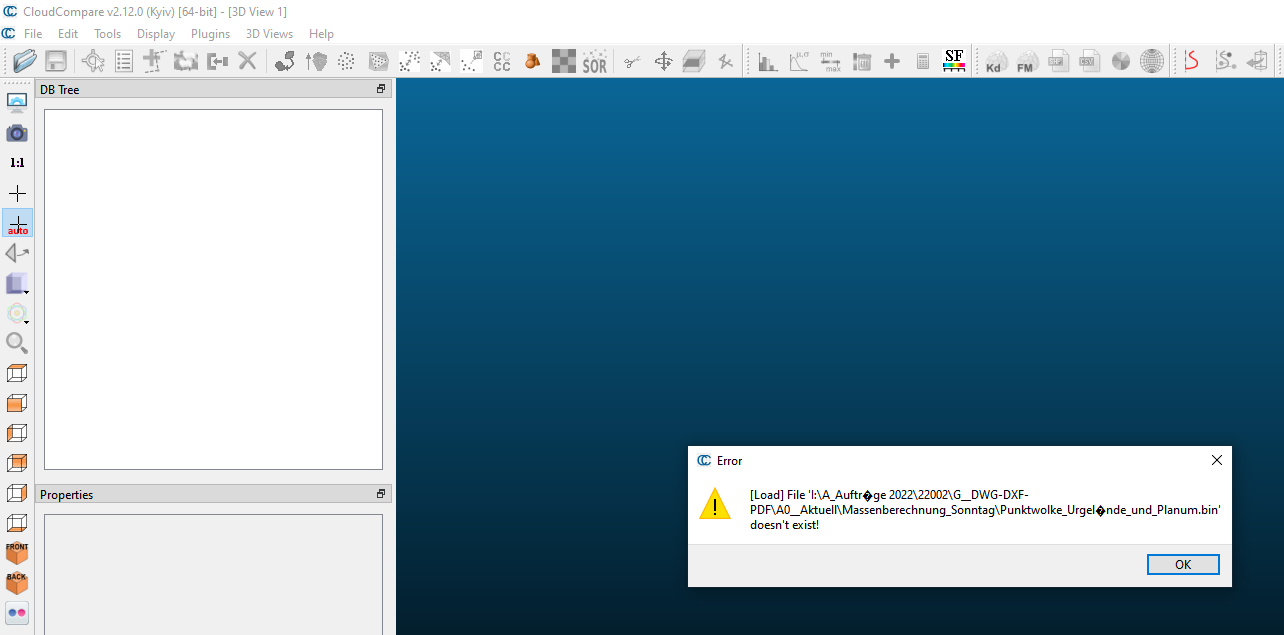

Cloudcompare seems to have problems opening projects if their path contains umlauts like "ä", "ö" or "ü" (German language).
See the attached picture

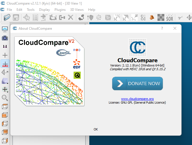

I tried it again at home with an older version of CC
and there was no issue!
Then i installed the most current version
and i was able to reproduce the issue again:
I installed this version:
https://www.danielgm.net/cc/release/Clo ... up_x64.exe

I've attached a ZIP file with two BIN-files containing umlauts.
Their names are:
Änderung_Test.bin
Testübersicht.bin
If you rename them, there is no problem. For me, it is not a workaraound, because our paths on the server contain umlauts.

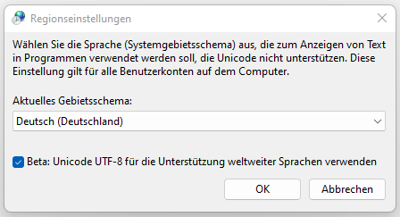

But I have found the error in the meantime. Windows 11 does not seem to have UTF8 encoding enabled by default. But this can be activated manually and after that everything works fine.
However, that doesn't explain why the same problem occurs on my Windows 10 PC at work. After all, it worked with the alpha version of Cloudcomapre that I had previously installed. However, I will check on Monday at work to see if there is also a way to enable UTF8 encoding there (however, the PC is in a domain).
Here is a video that shows the problem and also the solution (for Windows 11):
https://youtu.be/_o4e_otFims
Greetings
Thomas

Re: Cannot open Projects when path contains umlauts.
Are you double clicking on the file in the explorer or are you loading the file (or drag & drop on a 3D view)? I realize that if you are double clicking on the file and asking Windows to launch CC to open the file, the encoding is not preserved.
