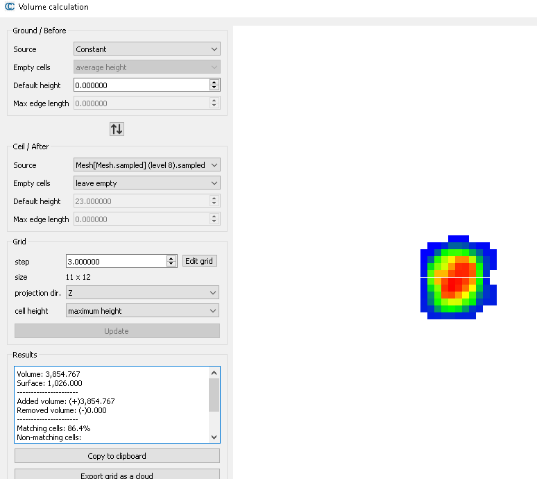

Re: Utilizing the 2.5D volume calculation tool
Ah, hard to tell!
I think it's really a matter of how 'accurate' (or 'inaccurate') the estimation of the total volume as performed by the tool is. Since it sums the volume of individual parallelepipeds (each corresponding to a square cell of the grid, delimited by the 'ground' and 'ceil' values). So maybe we could say that it's a matter of how many non empty cells are used in the computation. If it's thousands, then it's probably good (as the relative error is probably low). While if you only have a few dozen cells, then it's probably very bad.
But clearly that's tricky to give a clear answer as it really depends on the data...

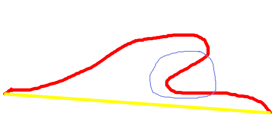

Post by DA523 »
First 2.5D volume calculation tool does not work on multiple layers pointscloud
2.5D volume accuracy depends on
1- How much is your pointscloud dense
2- How much is your pointscloud density regular (homogenous)
3- percent of the projected area to its perimeter
If you use underestimated (GRID STEPS) you get empty cells hence less volume
If you use overestimated (GRID STEPS), you get large cells hence a bigger volume (relatively depends on the percent of the projected area to its perimeter)
Usually, good practice on mesh (using sample points )gives real volume + 0.01%
You can do trials on this attached mesh against a constant 0 plane by changing (GRID STEPS)
Group12.zip
(1.84 MiB) Downloaded 678 times

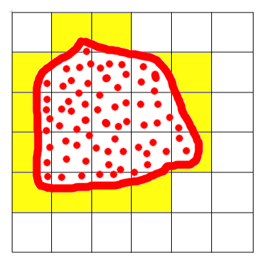

DA523
Posts: 187
Post by DA523 »
The yellow area around the perimeter shows extra volume (not true)If you use overestimated (GRID STEPS)
