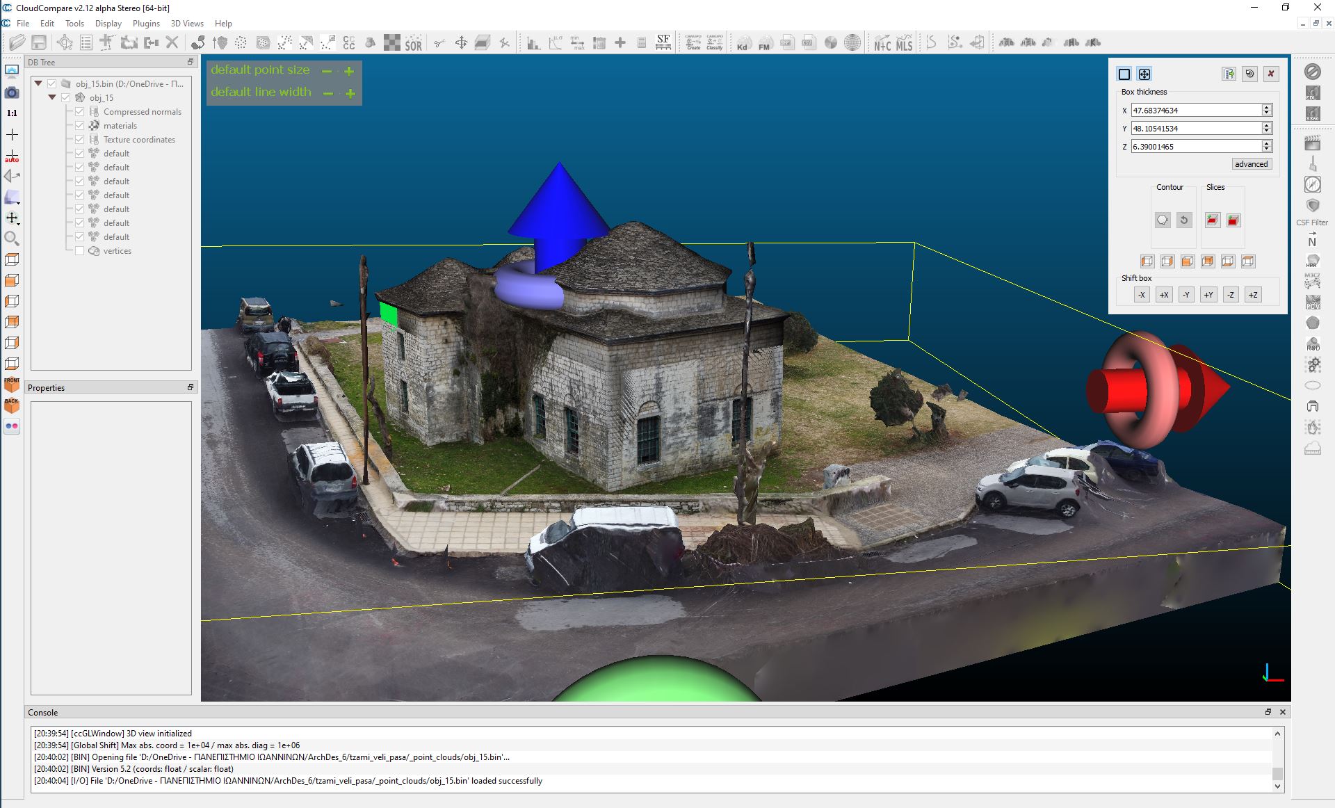

Yes for the cross section tool. I am sure it used to work. Now just shade the part I try to section.

by nikoue
take a look, please.
what I am doing wrong?

Ah, that's a glitch, because the sub-meshes (all the entities named 'default') are also visible and hide the segmentation.
The current workaround is to select all these sub-meshes, and deactivate them at once (shortcut 'a'). Then you'll be able to use the Cross Section tool normally.
I'll try to fix that asap.
