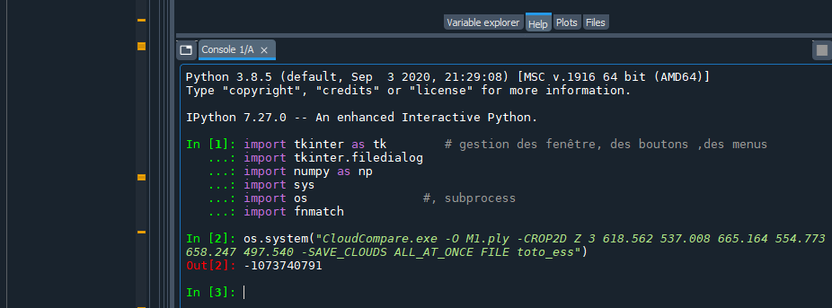

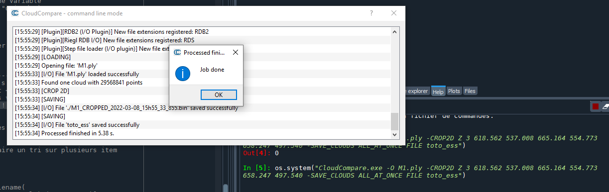

For the test with CC 2.11 you can see the attachment CC_2P11.png. The job is done and I have my result files.

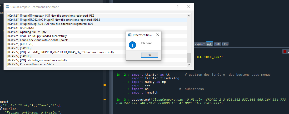

For the test with CC 2.12 you can see the attachment CC_2P12.png. It seem he don't run CC and I havent my result files.
If I test the command line directly in a "DOS command promp" the job is done for the two versions of CC.
