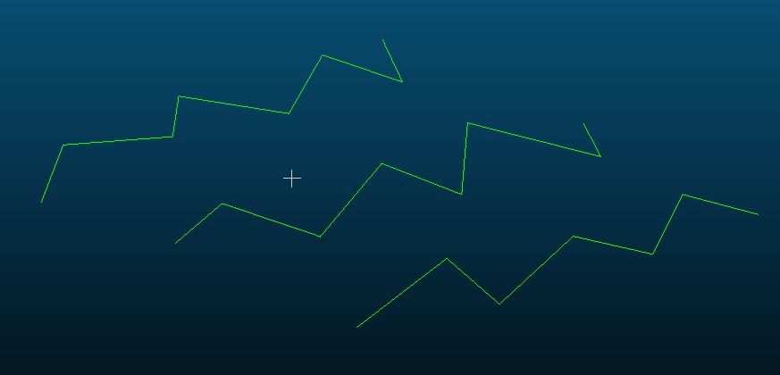

I couldn't reproduce the issue with version 2.12.beta at least.
I trace 3 polylines, save them to DXF, then load them again:
The file size is 9Kb.
Can you try with version 2.12 if possible? And if you still have the issue, can you maybe share the polylines (as a BIN file) with me? (daniel.girardeau [at] gmail.com)
