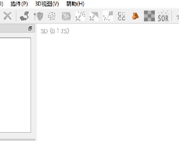

I installed cloudcompare in windows 10 in VirtualBox, but I found the mouse cursor is reversed when I drag the 3D model.
For example, I tried to drag the model up but the direction is reversed.
How can I solve this issue in Virtualbox?

I found the rendering window is reverted. The image is in the attachments.

I installed cloudcompare stereo and it works.
I am wondering what is the reason why cloudcompare fails but stereo works?

I found cloudcompare doesn't work in VirtualBox.
My host system is linux, and the virtual system is windows 10.

That's very surprising (the display flip). The difference between the 'stereo' version and the 'non-stereo' version is the 3D rendering widget indeed. Normally it's managed by Qt, but apparently something bad happens. It would be hard for us to do anything sadly.
