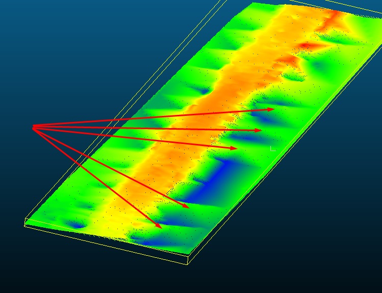

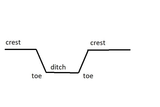

Post by mbmiller34 »
Hopefully, these images make sense. What happens is CC connects across the top of the ditch due to a lack of points. Manual GPS 10x10m grid to pick up low areas drone was unable to measure. So rather than having a true typical ditch profile I have weirdness. I can create it inside GM using manually defined break lines. Drew a polyline down the crest and toes but there should be a way to create the same inside CC. The blue low area should be running the entire length.

Re: Interpolation and breaklines
Ah I see. Sadly CC doesn't include the option to use polylines as constraints in the mesh.
In CC? I guess you have to manually add points at the bottom of the ditch ... Maybe create a mesh between the two toe polylines, ans sample points on the resulting mesh? It will be very manual though.
