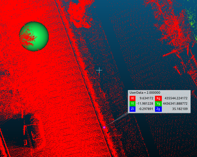

hello,
How to change the label color.
As shown in the picture, this dot shows magenta and I want to change it to another color such as yellow.
thanks

I wrote it like this, but its color didn't change.
	cc2DLabel* label = nullptr;
        label = new cc2DLabel("test");
        label->setVisible(true);
        label->setEnabled(true);
        label->setTempColor(ccColor::blue);
        label->enableTempColor(true);
        label->showColors(true);
        m_app->addToDB(label);

If you are referring to the point symbol (the sphere), then it's a global display parameter: https://github.com/CloudCompare/CloudCo ... ext.h#L107

I want to implement a function that loads two point clouds and then clicks on a point in the first cloud to change the color of the clicked point to, for example, yellow.
Then click on a point in the second point cloud to change the color of that point too, for example red, and then do other calculations on both points.
Then I came up with the idea of using labels to achieve such a function.
So I came to ask for help on how to change the color of the labels....
Re: How to change the label color?
Posted: Thu Aug 05, 2021 9:01 pm
I was surprised that your 'Y' label appears to be black instead of green. Have you changed that or is it a display bug?
Otherwise, I guess it would be easier to display (temporarily) some spheres where the points are if you want to achieve this result. You'll be able to control the diameter and color of each sphere.

'Y' tag that problem I do not know what happened reopen the cc once and it is fine.
If you load the sphere, the view is not as good as label, as shown in the picture
If you zoom in, the ball will become very large and block many points.
And label will not.
Posted: Thu Aug 12, 2021 8:12 pm
Then if you are in a plugin, you could probably create your own entity that looks a lot like a 2D label (but that only implements the sphere part) so that you can control the color, etc.
