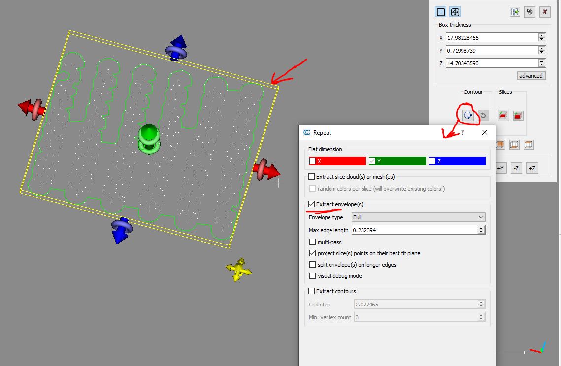

It should not matter if they are not on the same Z level, I think the confusion is terminology, in the cross section tool under extract contours, the thing you are asking for is called "Extract envelope" rather than extract contours.

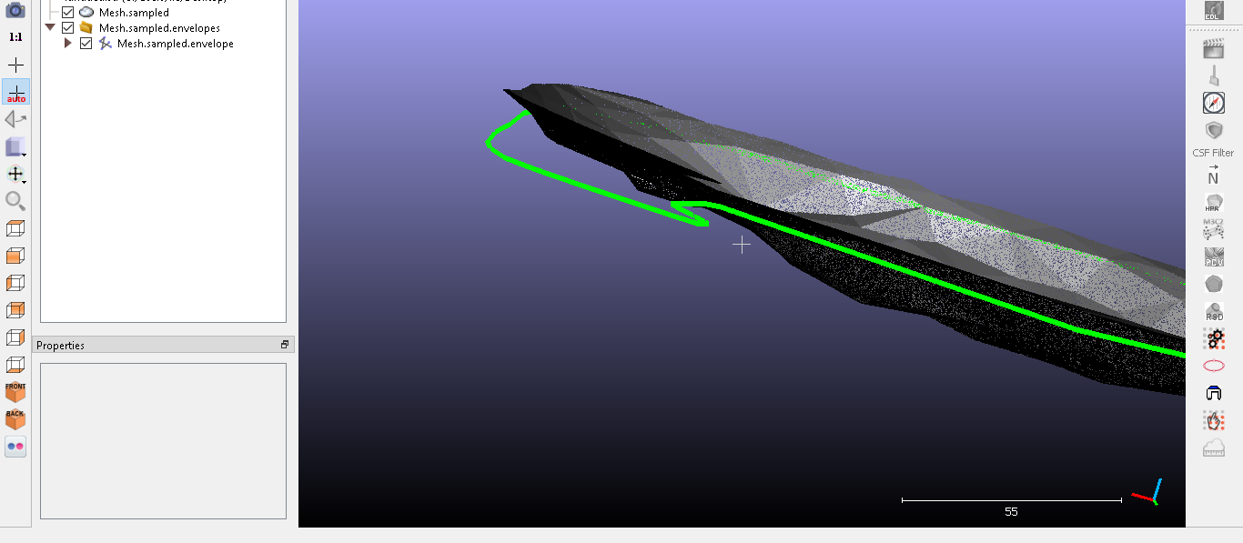

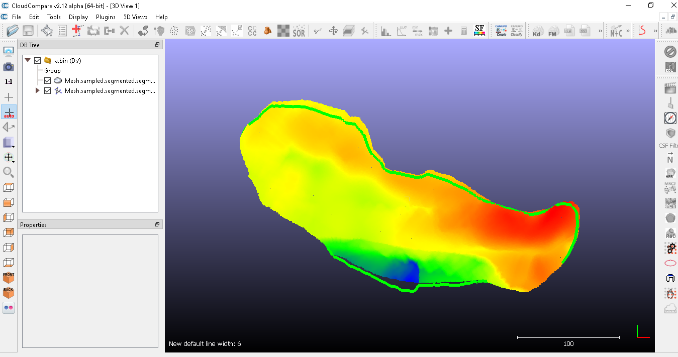

This helps a little but Z values of polyline does not match Z of perimeter of mesh?
XY are OK
The goal of extracting of mesh perimeter is to build with minimum manual intervention more realistic cover for mesh instead of close hole function in Blender and FreeCAD etc
This cover is to be used as upper cloud points for volume (2.5Dvolume) calculation in CC and GIS etc
Re: How to extract cloud points perimeter?
Posted: Thu Jul 22, 2021 8:42 pm
by WargodHernandez
you could extract z coord to a scalar field for storage, then set all Z values to 0, then extract envelope, then measure distance to primitive, then restore the Z coord from the scalar saved earlier
Posted: Fri Jul 23, 2021 9:54 am
by DA523
I will try this approach.

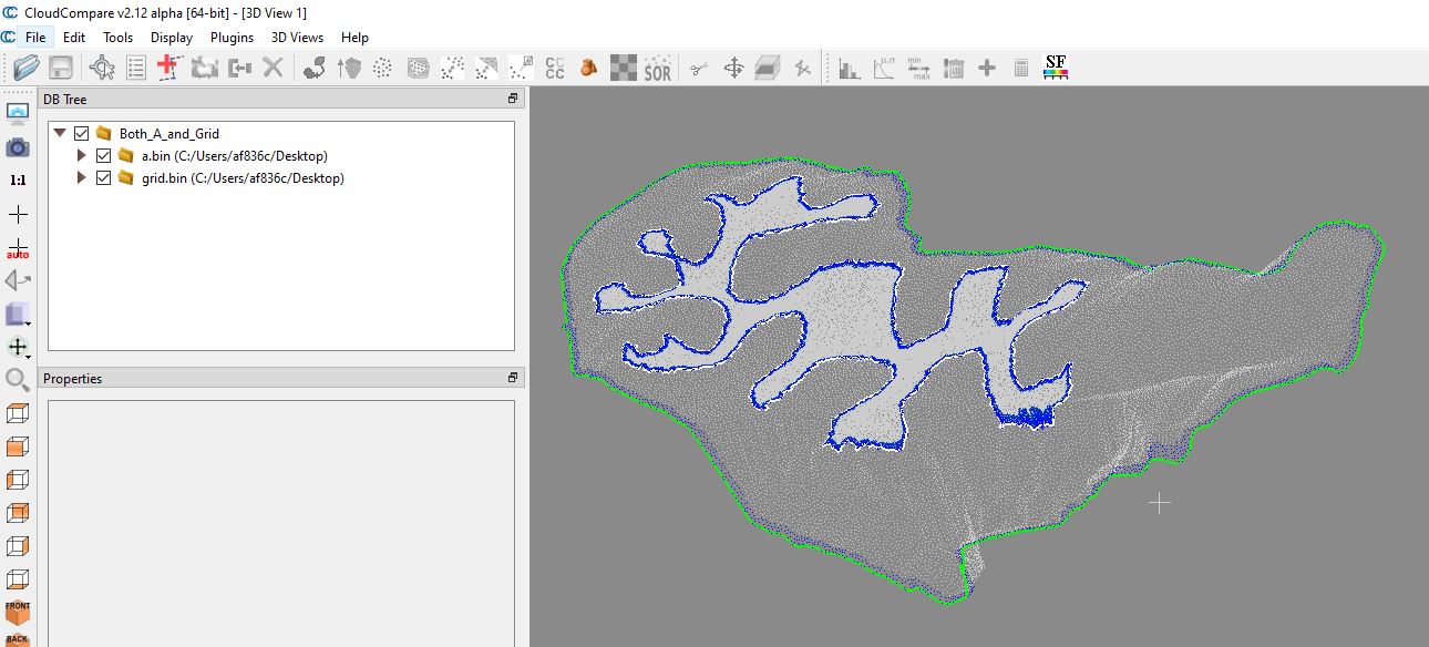

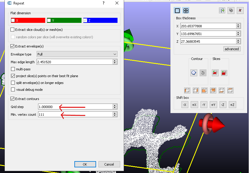

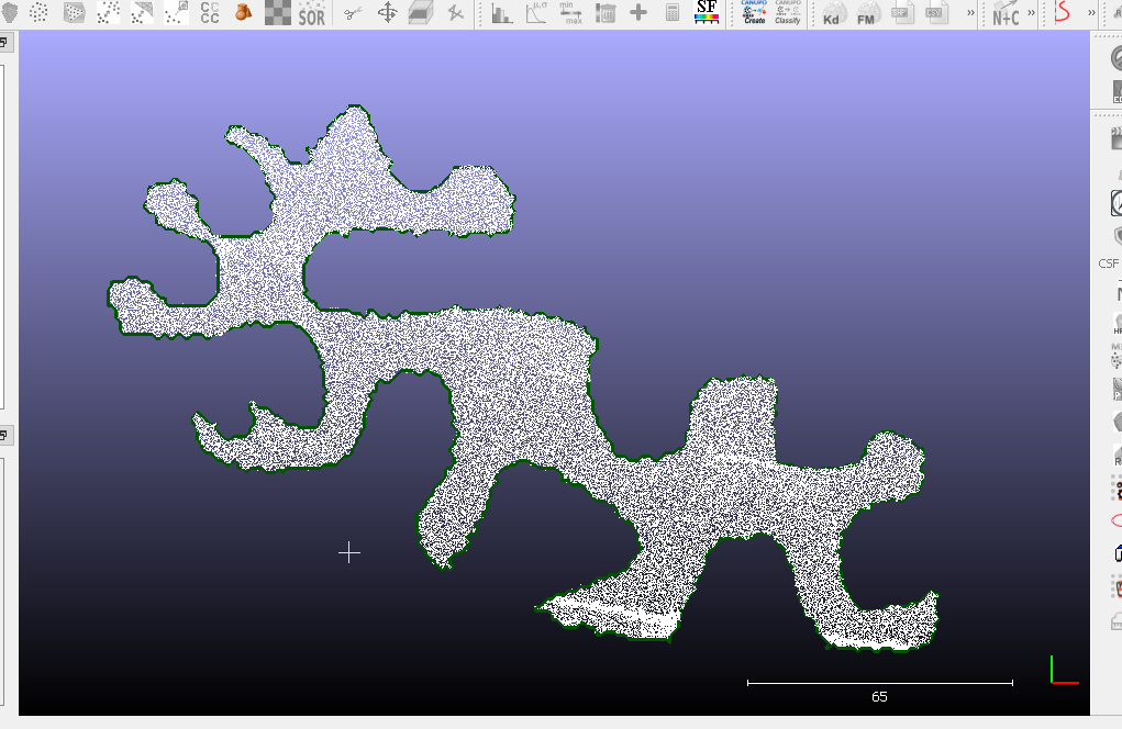

However, I found that polyline contour sometimes is not accurate in xy plane especially if there is big variation in mesh Z
see in image below
But playing with grid step & min. vertex count makes result polyline accurate in xy plane
a.zip
(447.55 KiB) Downloaded 2321 times
grid.zip
(1009.13 KiB) Downloaded 2416 times
Posted: Fri Jul 23, 2021 4:21 pm
by WargodHernandez
I had good success following what I told you, zeroing out the Z value getting the contours then restoring the Z values. only extra step I didn't mention was to interpolate the original clouds SF values to the vertices of the extracted contours and restore the Z SF to the vertices as well to get the contours to follow up to the original locations.
